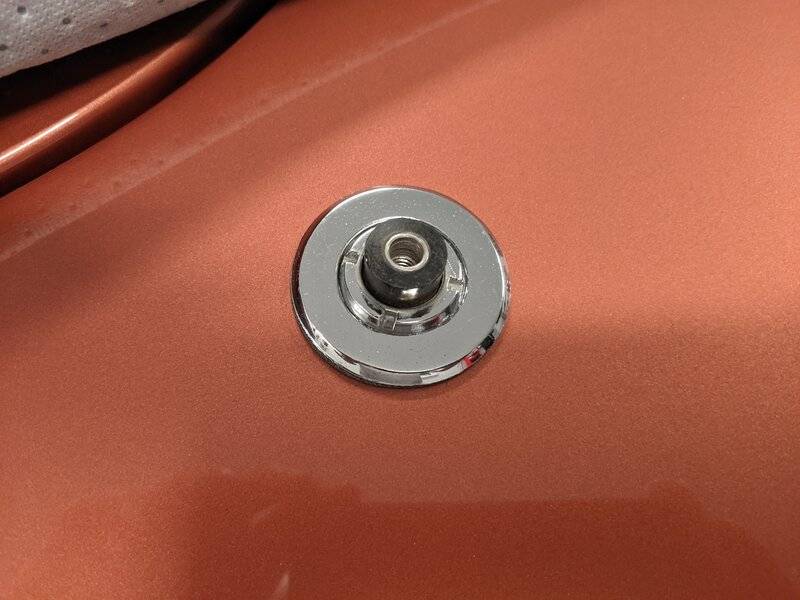

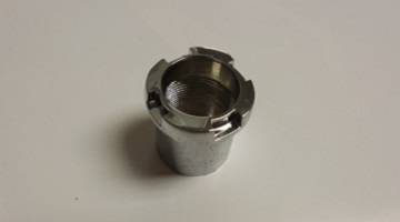

I've ordered two different antenna nut sockets that are not the correct sockets for my '68 Charger.
Here's a pic of my antenna nut. Can anyone tell me the correct socket I need to order for my application?
Part #, vendor??

This is the original antenna and nut that has been on the car since 1978. Not sure what happened before then. I suppose it could have been changed in the early years.
I'm not saying it is not the one that came on it, but it's one I haven't seen before. There are adjustable spanner wrenches out there.

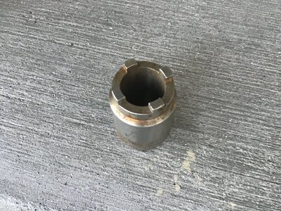

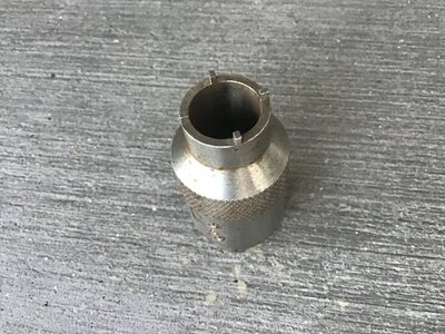

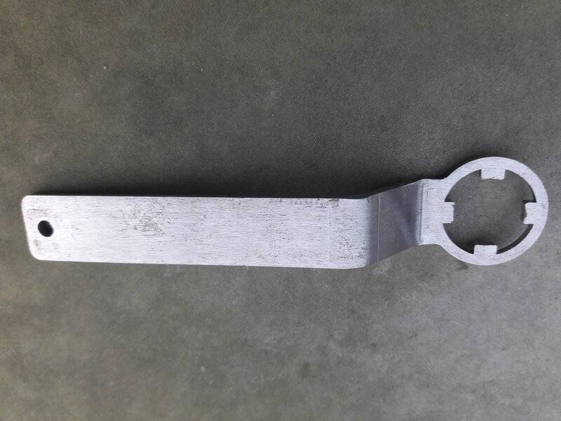

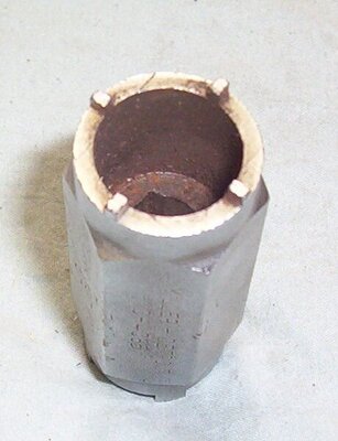

Bob, the indents on the retaining nut do not have the proper width to them as I have seen for the two different styles that were available for those years. The A-Body style is similar to what you picture, but it has like six indents. The B-Body style has the four indents for the 68 to 70 applications. Attached is a picture of the wrenches that we had made up for the different style of antennas.

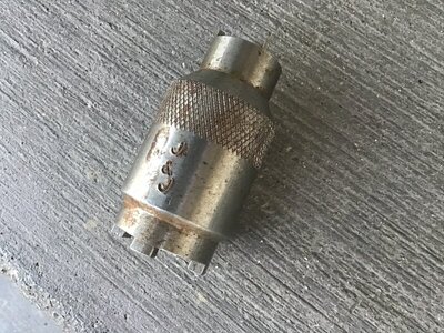

The 1967 antenna nut has 8 narrow slots sized like yours. My tool has 4 narrow tangs on one end and 4 wide tangs. It is stamped with J & J on the side. Don’t remember where I bought it. Was 15 or more years ago.
I’ve never seen that nut you have.
7412C64A-C6FC-440B-A483-8516856264CA.jpeg 11FE41DD-2709-4B6A-8530-599C5E59EEE6.jpeg 77A022D5-88AC-4F24-86EC-F966BCF9CFA1.jpeg C71FE04C-8B8E-4683-859B-910E405E5FE6.jpeg

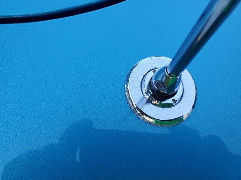

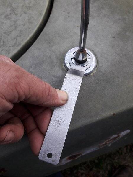

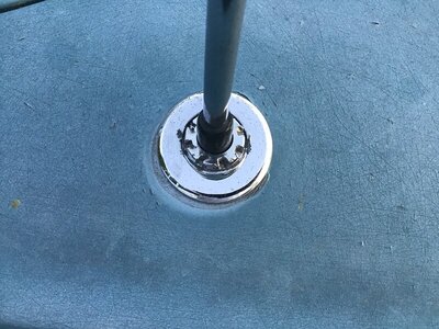

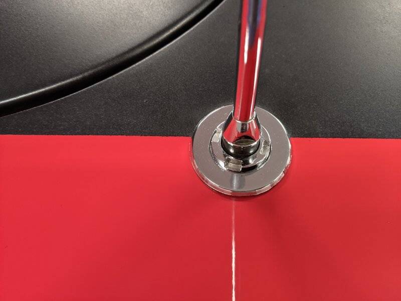

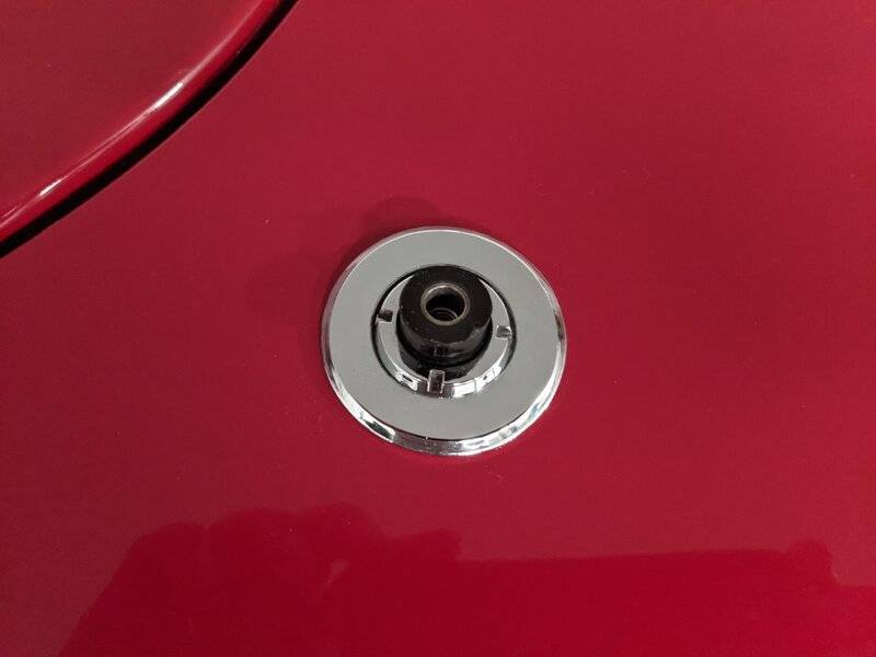

Here's what I have for original antenna nuts on my 3 cars...
1968 Charger: Build date 12/67. I repainted the car last year & prior to that, the original paint was on this fender...

1968 Charger: Build date spring 68. 38,000 mile survivor...

1969 Road Runner, build date 5/69, 33,000 mile survivor...

Ahhh! So I do have the correct nut! Your two '68's are identical to mine. My build date is 06/68.

Reading the rest of these posts shed some new light on this nut deal. I will look at my 68 parts manual to see what it says. I also will look at the tool I have and get you the number.
From my experience, the same antenna nut was called for from 1968 through 1974 for all of the A, B, C and E-Body applications. Even though you might find a variation in the part as we are now discovering, they all carried the same part number or it was superceded later in production for the different year models. That is why survivor cars with the assembly line parts can differ so greatly from a OE restored car with NOS parts that were bought across the counter.
If you look at the antenna bezels for a 68 to 70 Charger as compared to a 68 to 70 B-Body except Charger, it is very difficult to see a difference. They carry different part numbers and difference is almost impossible to view. Things to drive you crazy.
