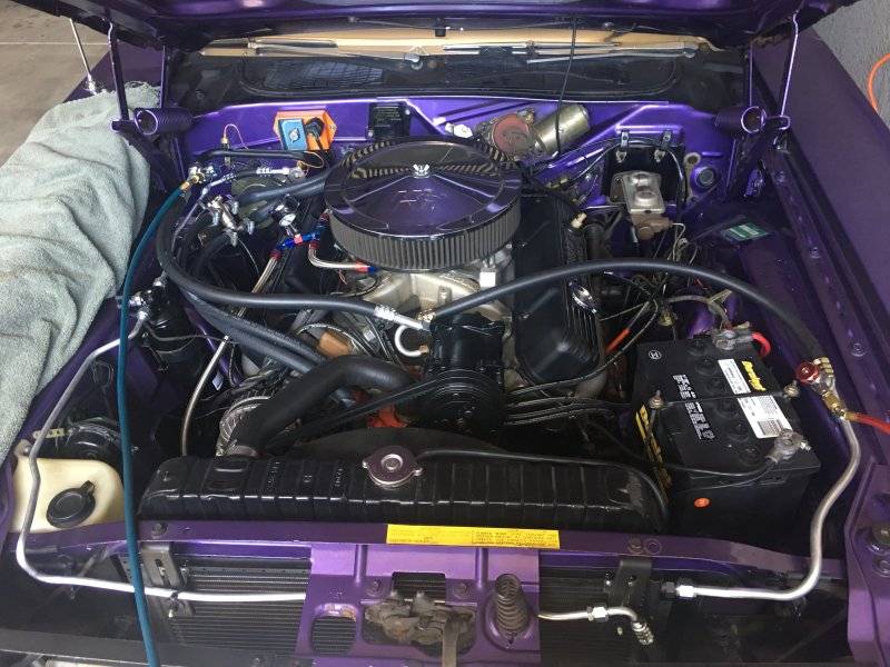

I like the 70 routing, wonder if I should go that route. On the purple car do they give you enough so as to get the left high side in front of thevalve cover or to much of a curve?

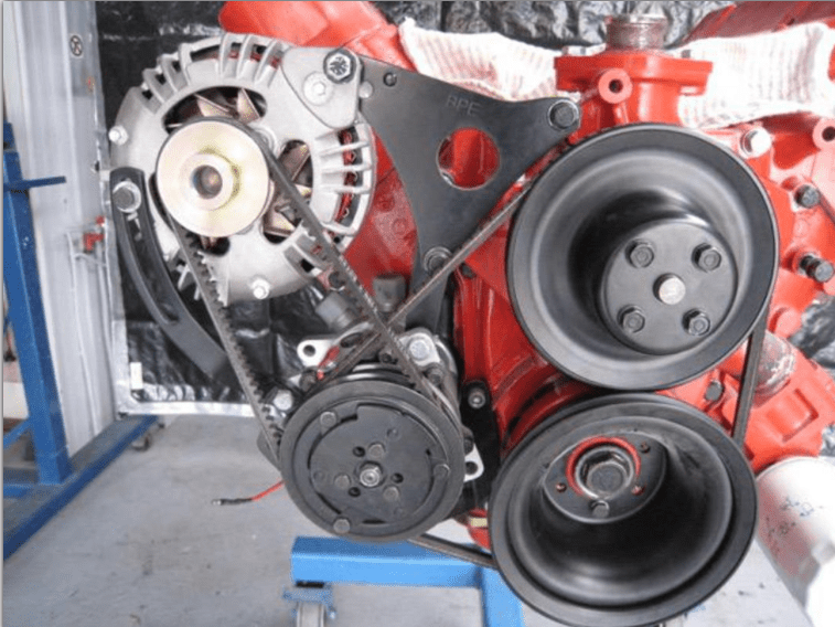

My friend Gary mounts the aftermarket A/C compressors under the alternator,no interfearance with the Air Grabber setup at all.
Bouchlion sells brackets to do that.. I know a couple people who have done it & they both say they wouldn't do it that way again, The alternator is driven off the A/C compressor & both are driven by a single belt.. On a hot day the head pressure rises causing the first belt to slip so not only does the A/C not keep up but the alternator doesn't charge...

The compressor ports are a couple inches back from the from of the valve cover so either you go over the valve cover or you have to do rigid lines... That car was a friends, he sold it & the new owner wanted A/C installed before it shipped. I didn't have time to do it as clean as I would have liked.. I wanted a longer rigid line for in front on the condenser, I would have liked to make a shorter hose for the high side, that hose was made for a different job but was available & would work so it got used.. I posted that picture more because of the black compressor than anything else...
On the 70 routing, I agree, it worked well..

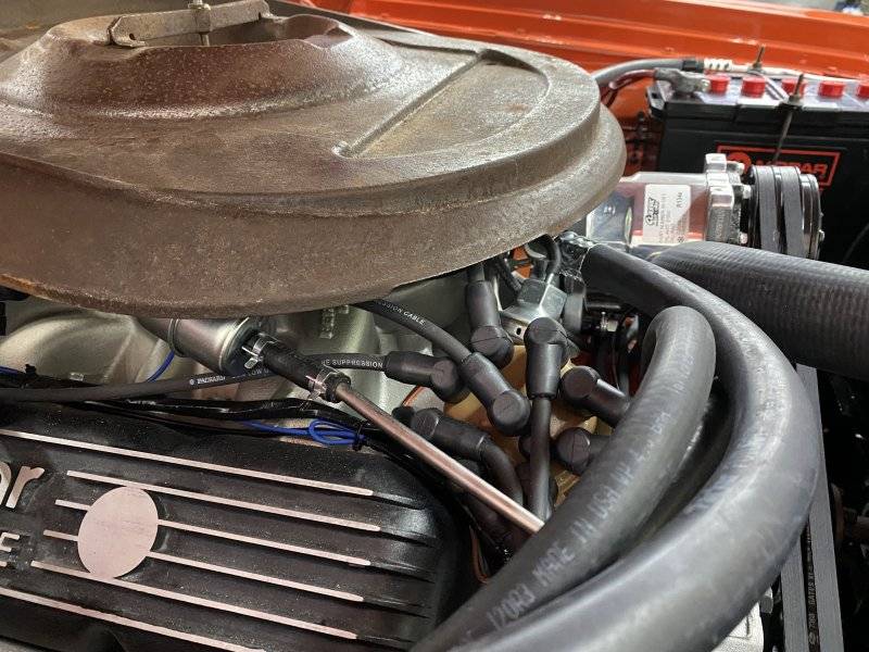

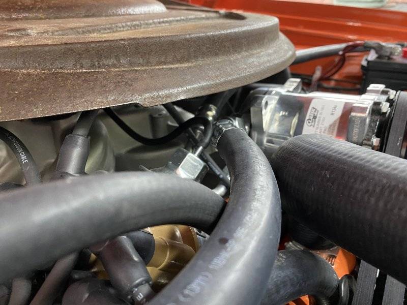

I also used the 180 connector to run under the air cleaner on my 71. I also have a 440 air grabber base so I popped it on to see how it fit. Plenty of room above the compressor. 440 with RPM intake. Classic auto air brackets. Edelbrock AVS carb. I don't have a ramcharger hood so Can't verify the seal fit.
Bouchlion sells brackets to do that.. I know a couple people who have done it & they both say they wouldn't do it that way again, The alternator is driven off the A/C compressor & both are driven by a single belt.. On a hot day the head pressure rises causing the first belt to slip so not only does the A/C not keep up but the alternator doesn't charge...View attachment 1325848
Gary never had any issues,even on the Power tour,and on the track at Watkins Glenn. Gary didn't use a kit,he fabbed it himself,A/C has its own belt,not linked to the alternator.
