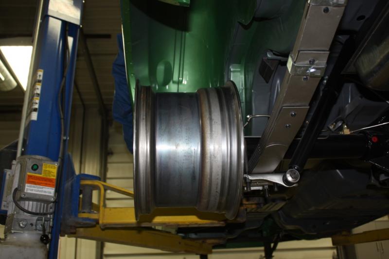

A 5" - 5.5" backspace will fit, but definitely not 3.25.
I think the 3.25" back space is going to push the wheel too far to the outside of the car. For a 15x10 to center in the factory wheel well you need 5" + back space. Picture below is of my 69 Bee. I don't know the answer with respect to the tire size.

Thanks guys, thought that was the case. I was hoping they might squeeze in, I'll have to go back to keeping an eye out for some rears.
