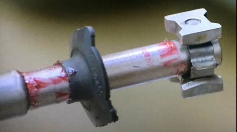

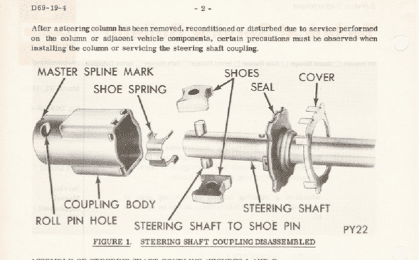

Too bad he installed the shoes wrong. (From the video)...
They should be orientated like this...
The flat part of the shoe goes toward the shaft, beveled goes away from the shaft so it can pivot inside of the coupler body. The way he installed them the coupler will bind.
Yup... Didnt notice that.. But you are correct.

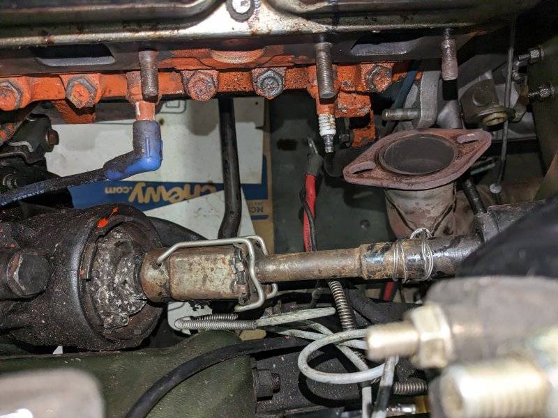

This clip.?
Not sure I have a secret on how.
But ..ive done a couple of them.
And hands down its much much easier with the column out of the car.

This clip.?
Thanks, Yes this clip. You guys are great!! I have the exhaust manifold off so I can get to it pretty easy, the end cap of the coupler if falling off so to get it to stay where I need it and get the spring on at the same time seems about impossible. I might try to do a little bending so its not so tight to get on or something and make another run at it..

Thanks, you know what.... I think your right, its sprung a little tight.. Maybe a pair of linemans pliers and a vice is my answer here.. I appreciate that.. Jay
I helped put one on a Roadrunner and I believe I had to do some subtle bending of the wire to better conform to the coupler dimensions. That helped make it difficult to get into the roll pin holes, versus impossible to get into the roll pin holes. I think the best thing would be to work it on a bench and tweak it until it fits. I think it was the 45 +/- deg wire bends before the 90 deg bends to snap in the roll pin hole, that I had to relax a little. I think.
