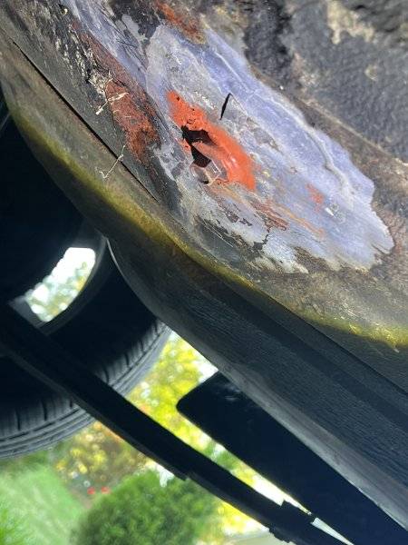

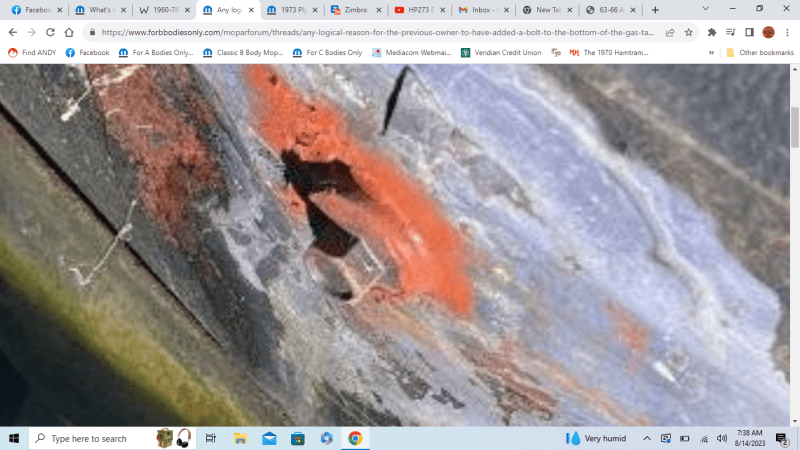

I noticed it awhile back and just now got around to taking a picture of it. I can’t imagine a scenario in which I’d add a bolt to the bottom of my gas tank but here it is…any idea why they did this? In what safety world would it be ok to drill into a gas tank? You’d hope it was empty when they did it.

Two things come to mind. Both are not my way of doing things (just sayin') First the tank may have gotten punctured and the bolt serves as a plug. Second it might serve as a drain. That bolt might even be one of the after market automatic transmission pan drain plugs.
Maybe a drain if it’s at a low spot in the tank. Not sure how well that would work though in sheet metal.
Fixed a leak. I did it once in my apartment parking lot on my pickup because it was leaking all over and I was heading 400 miles home in a day or 2 and would have much better access to tools there. So, found a screw, cut a little flap of rubber off one of the positive battery post covers, screwed it in and drove it home. Held fine.

The shops that clean and seal tanks put a drain in them for their own use. They don’t tell the customers and then the customer is not very happy About it.
Maybe someone used it to attach one of those grounding straps. LOL
It looks like a drain plug from here. (And not a "bolt")
My 60 Dart Phoenix has a factory installed drain plug. It is the only car I recall ever seeing one in. I have mentally thanked the engineer for it a few times.

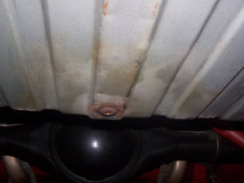

During Resto had my Radiator shop add low point drain bung , to my new fuel tank, comes in very handy, for draining the remaining fuel from tank! Fuel has a poor shelf life , and easy to remove remainder of fuel, for storage! Works great!

The area around the 'bolt' has been cleaned with a wheel or grinding disc. That looks like a purposeful bung like in your engine sump.
Someone did this on purpose as the bung is in the lowest point of the tank for drainage.
Leave it alone.
