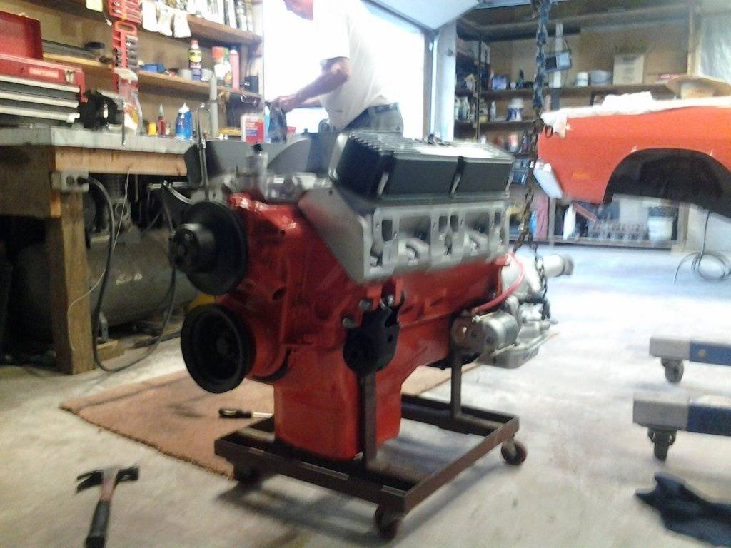

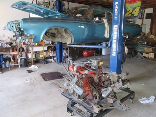

Here is a 440 six pack on a purpose built dolly - looks cool ....I might build one of these. :lol:

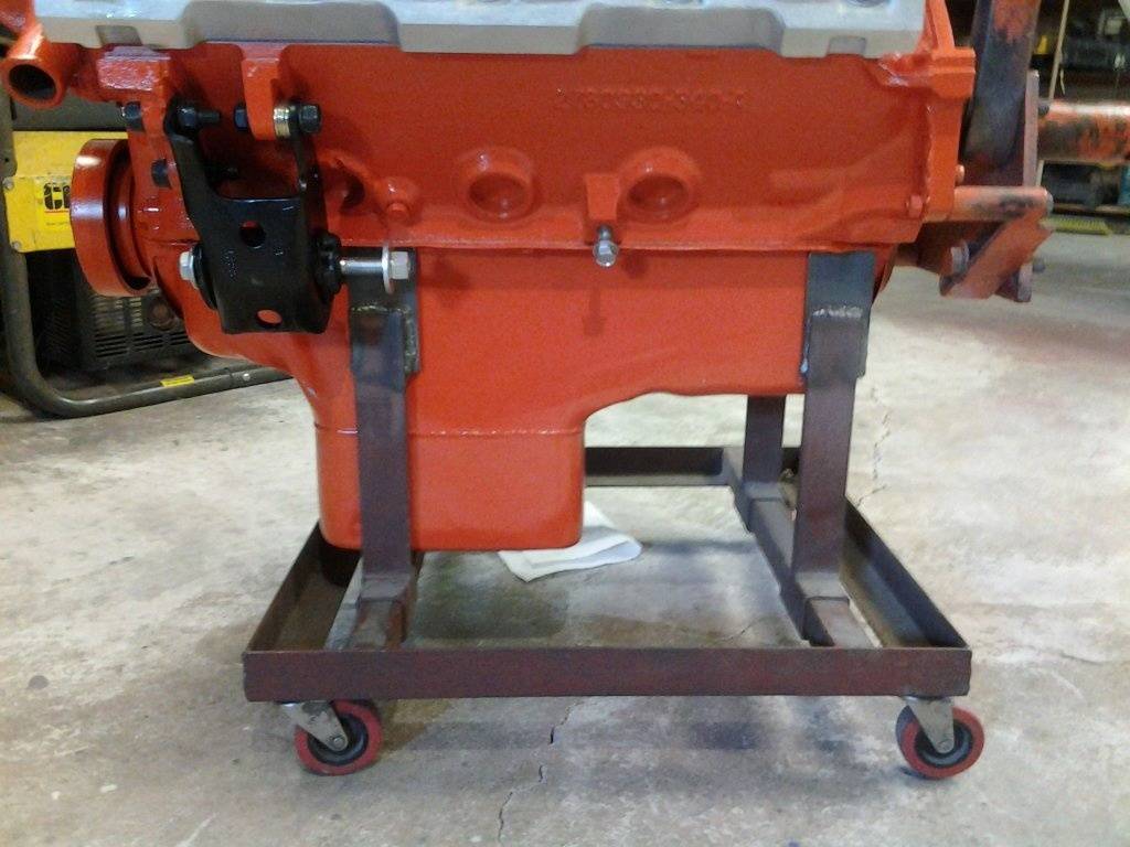

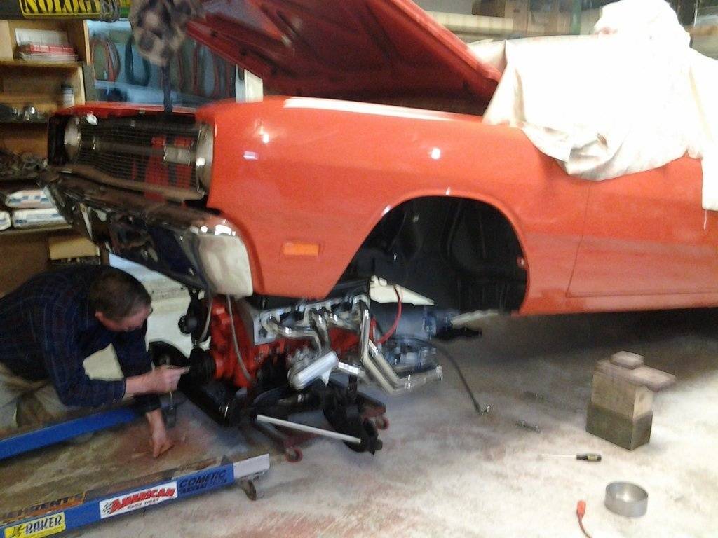

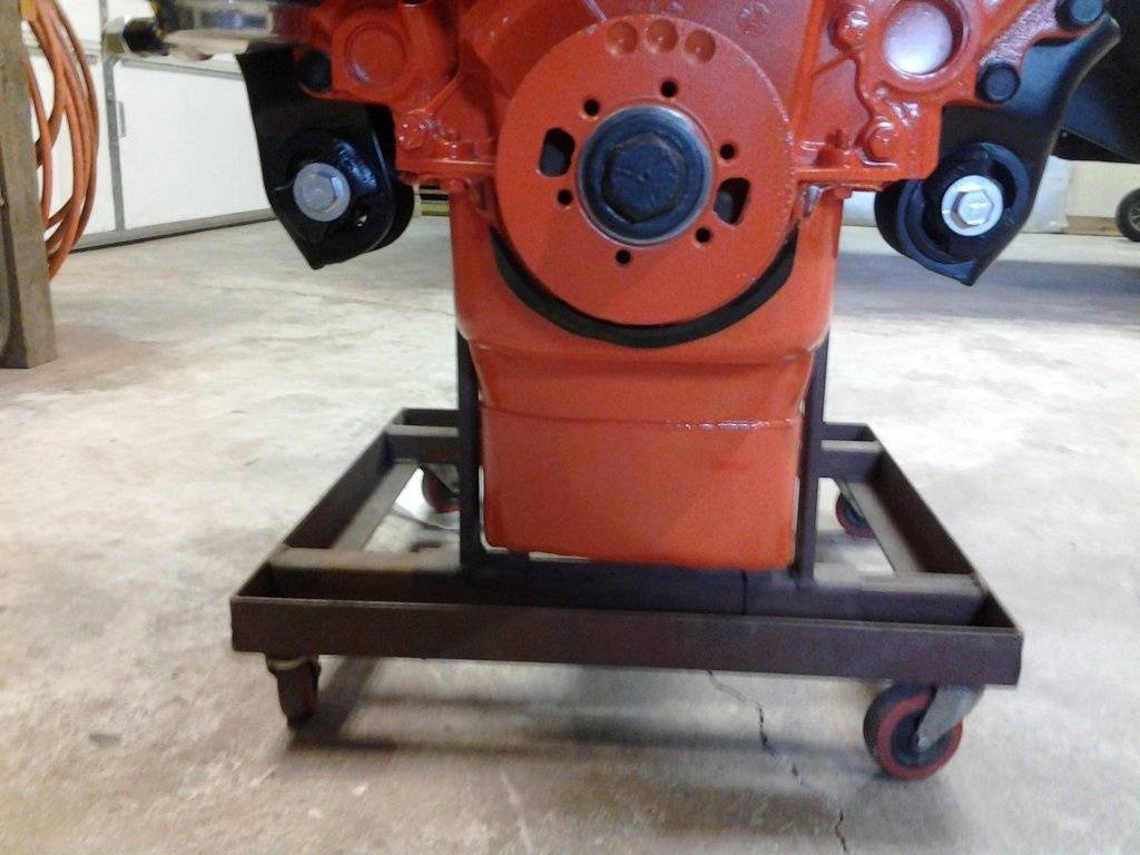

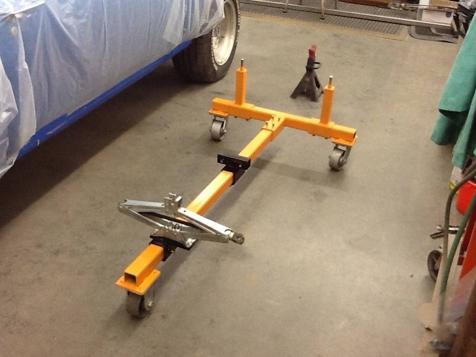

Here's one I built though I don't have provisions for storing the rear axle it will
be used to support the rear axle for tear down and reassembly once the engine and tranny is off and in the car.

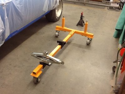

here ya go. Click it and it'll download a PDF file.
  • Drivetrain_dolly-Layout3.pdf

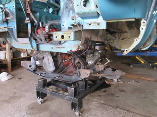

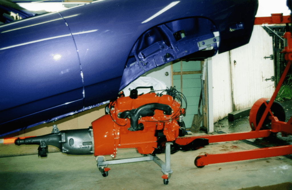

Here's a couple pics of mine. Came from Year One...
Simple is better for me...
It's not fancy..not uber overbuilt and works like a charm...
Best of all its not in the way of anything else when installing the engine from the bottom...
Excuse the A body...:D

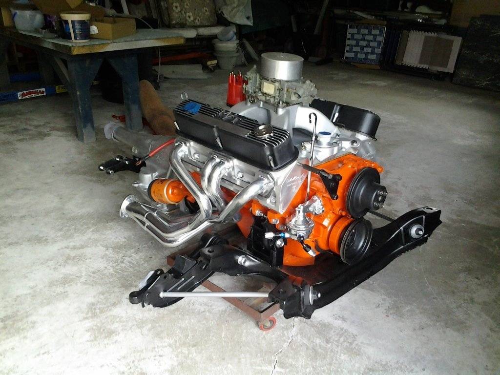

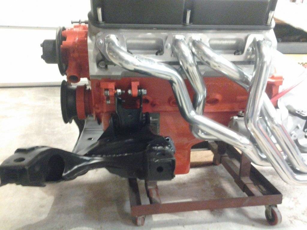

These are all pretty good ideas. sticker is that just on there with gravity?sticker, i like the style so you can support the motor but still mount the k member an roll it around. my only problem with that is i have such a crappy floor, i envision me pushing it along, and a wheel snags, the whole cart stops with the motor keeps moving... ask me why i WILL NOT use a three wheel engine stand anymore...
The one i made pictured above has locating pins for the k member and you could do pnuematic tires for rough terrian.
