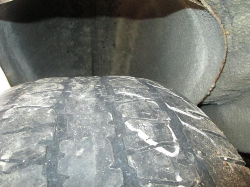

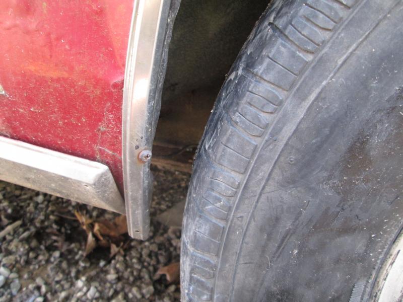

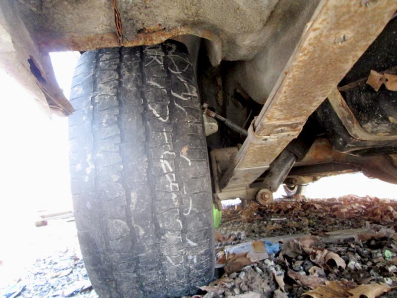

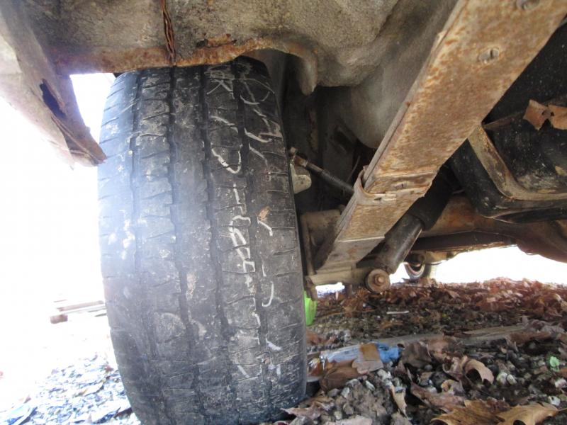

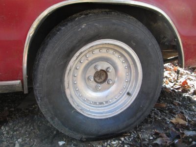

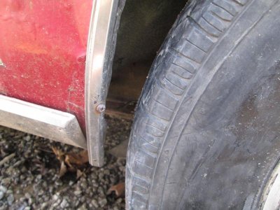

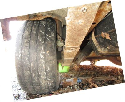

Here's a few shots... (wow I didn't realize there was that much rust and crap under there... and don't mind the bald tires.. I got them used for $10/ea to check to see if they'd fit on mine)
66-67 Charger is a whole different ball game from a 66-67 Coronet. Charger wheel opening is bigger.

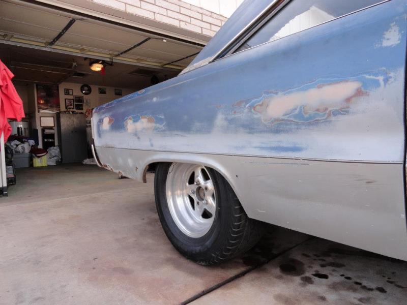

i ran 275/60/15's on weld 15x8 w/ 4.5 BS and they fit perfectly.satellite.jpg
sorry i did not have any frame clearance pics, the car is mini tubbed now so that ship has sailed.
