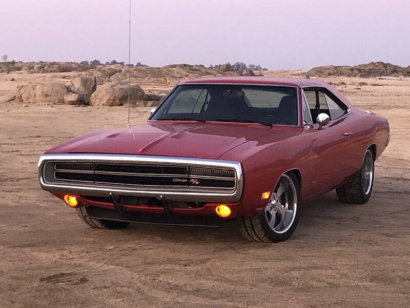

here’s the car

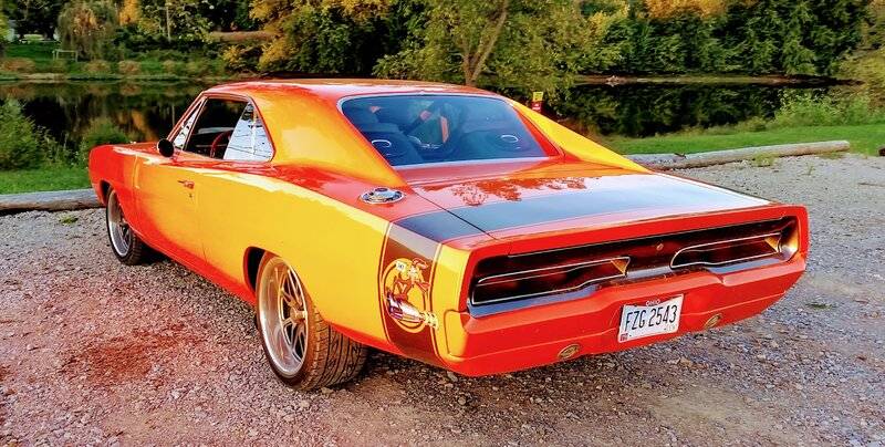

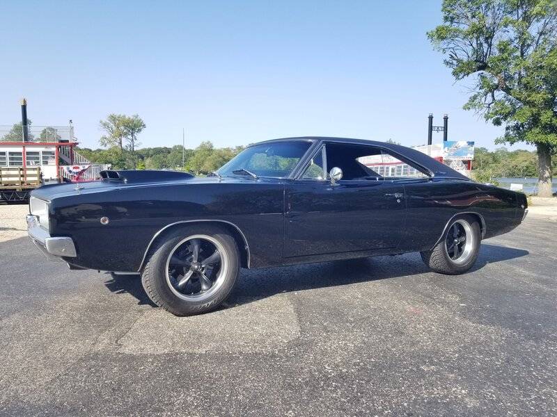

While many "seasoned" enthusiasts prefer to stick with the 14 or 15" wheel based on appearance or the belief that shorter sidewalls give a poor ride, I see many guys with 17s and 18s like mine that I think look pretty good.
I am not a fan of razor thin tires on a classic car. There are thousands of wheel styles out there that look horrible in any diameter. The 17" aftermarket versions of the Mopar Rallye wheel is a great design. Many of the Torque Thrust wheels look nice though they are a bit common. I chose a wheel that looked like a modern version of a Cragar.
The wheel is a 18x10. The tire height is 27 1/2" so that leaves a sidewall of about 4 3/4".
When I see a 15" wheel with a 28" tire, the sidewall looks too tall for my tastes. There is a sweet spot in there in between.

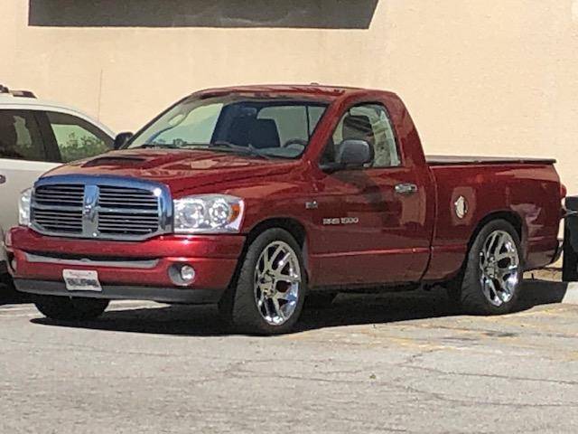

The tires on my truck are a 305-40-22. They don't seem like their sidewalls are too short.

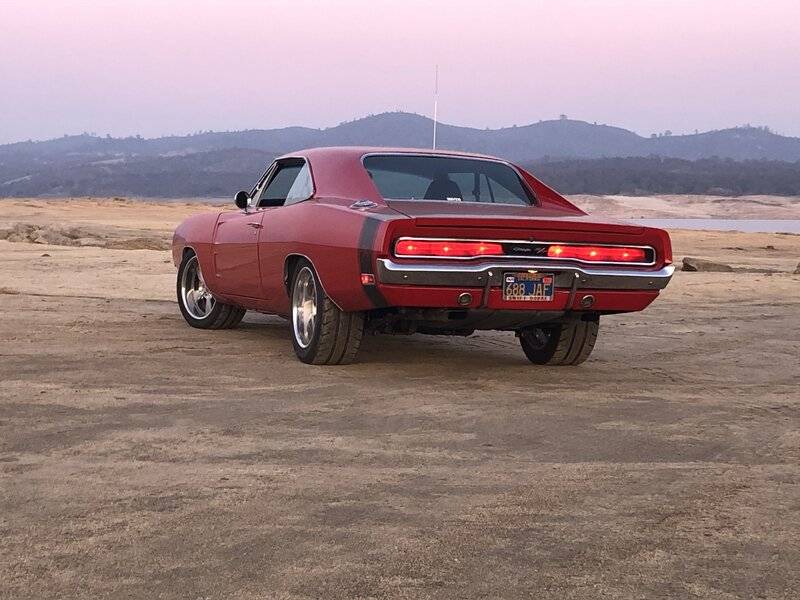

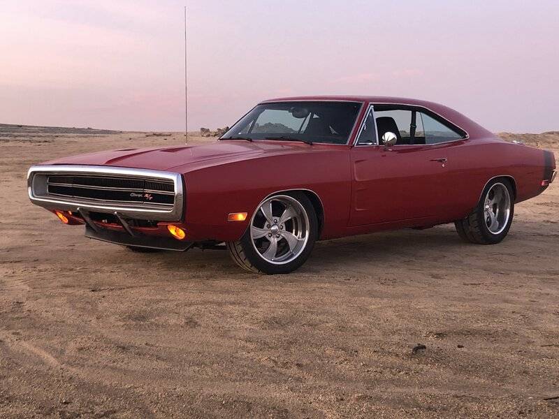

Holy crap! JUST KIDDING. Can you imagine. Lol lol. Your charger looks AWESOME! Love the rake, width, style, all of. Those wheels are nice, never seen them before. They sort of have a ‘salt flats’ feel but not. I’m an advocate for ‘do what you want’

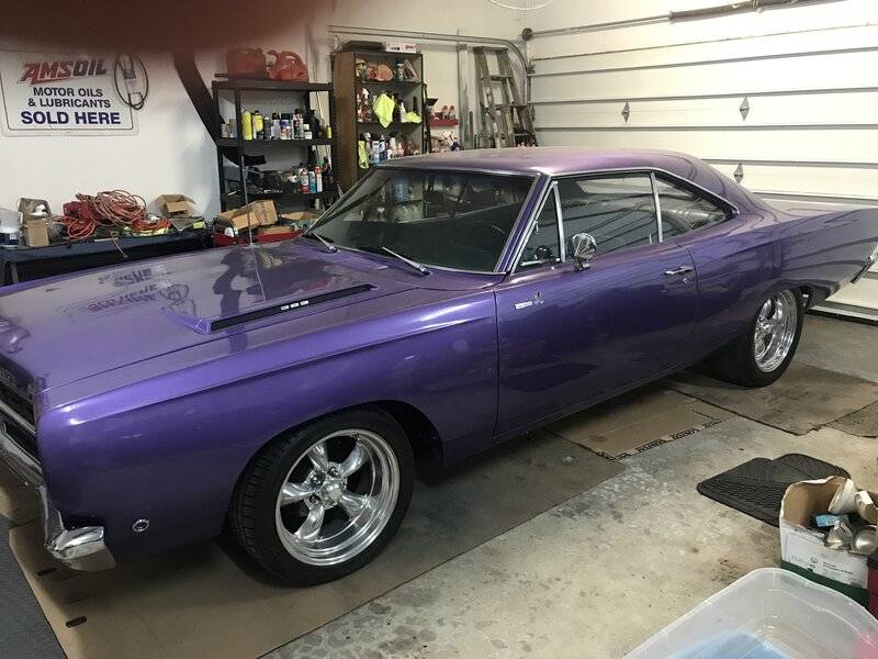

Kern Dog's wheel and tire combination is one of the few larger than 15" combinations I like. My buddy Bill has some nice charcoal grey 18" 10 spoke pro touring wheels on his 70-1/2 split bumper Camaro that doesn't look too bad either.

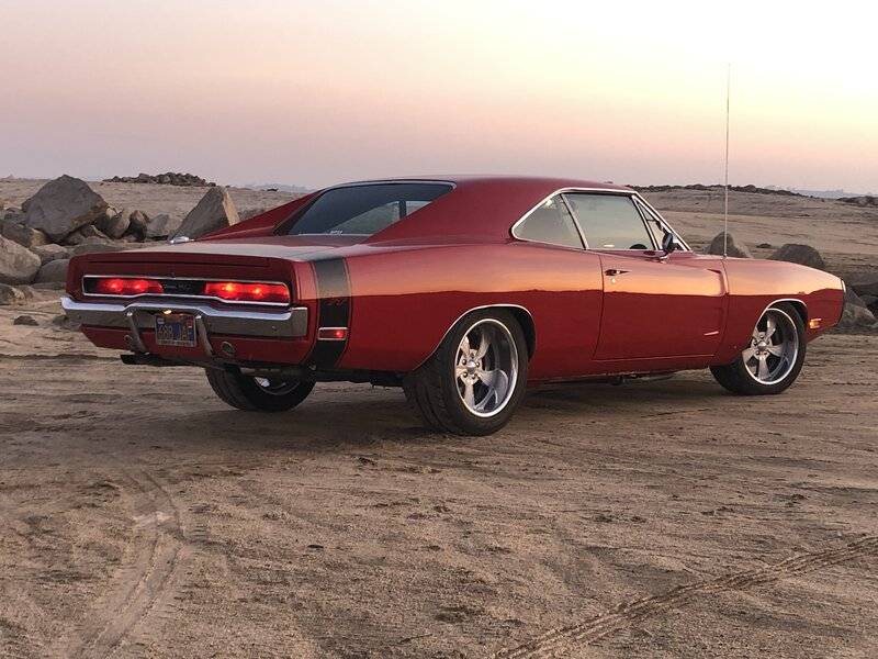

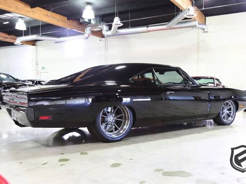

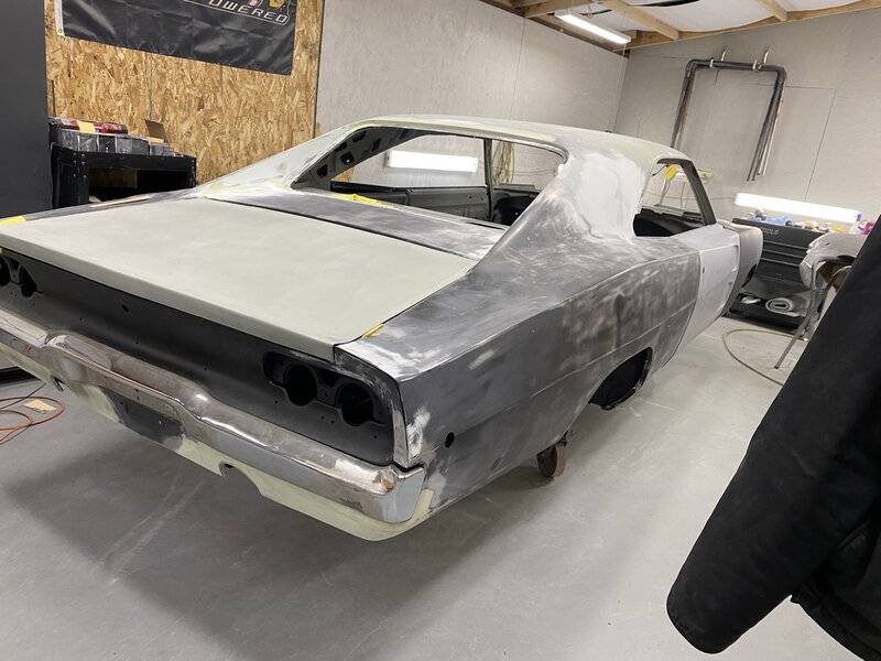

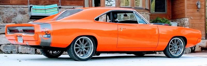

18x10 in rear 17x8 front on the RR. The Charger will have 20x12 in rear and 19x9 in front. Photo of what the stance will look like from Speedcores photo,
F3623773-8A0A-4391-9CE7-72D2F9A8A787.jpeg 988BB245-F4CF-4E75-BB06-AA762F686435.jpeg CA58B399-BCBB-40D5-90F8-F8287CBF0CF0.jpeg
Does anyone know if I can go 19x10 or 20x10 in the rear without mini tubs ?
