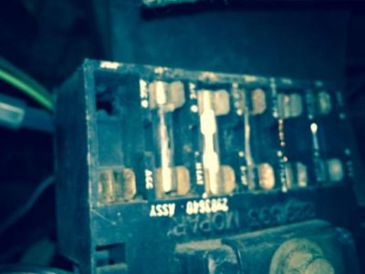

Any suggestions on how to fix this? I'm missing the bar for the accessory fuse at the top. If anyone knows exactly what this fuse is for I would appreciate it. I know it's for accessories but what exactly.
Okay... I remember this subject! I will look tomorrow for a fuse panel and report back.
I have a couple/three of those, but they all have varying degrees of rust scale on them. What you need is a wire terminal that has the fuse holder on the ends. Turn your panel over to see the other ones in there. Not sure who reproduces these. If you cannot find new, a used one can be made to work if you have any skills at soldering. let me know...I can send you a fuse box that you can use for parts.
I own a 70 RR convrt and plan on adding a Painless add on fuse block. Going to add power windows, nice stereo system and alarm system and stock fuse block does not cut it.
Catalog http://www.painlessperformance.com/PDFCatalog/ and go to page #92 for Add on Fuse blocks.
