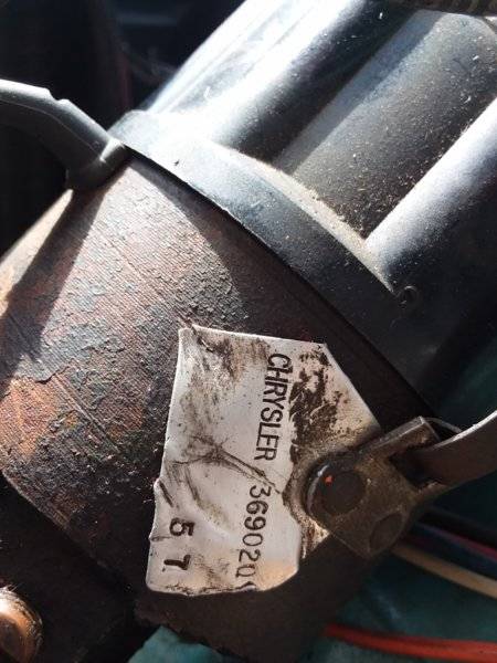

Just wondering if anybody has seen this no. before bought a lot of stock car parts in the 70s and 80s the only way we could get Hemi parts. Now I am going to start selling the stuff can't seem to find this part. I know there is a lot of sharp guys on this site. Sorry have pictures took them today can't figure how to put them on have to get help.

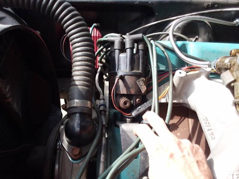

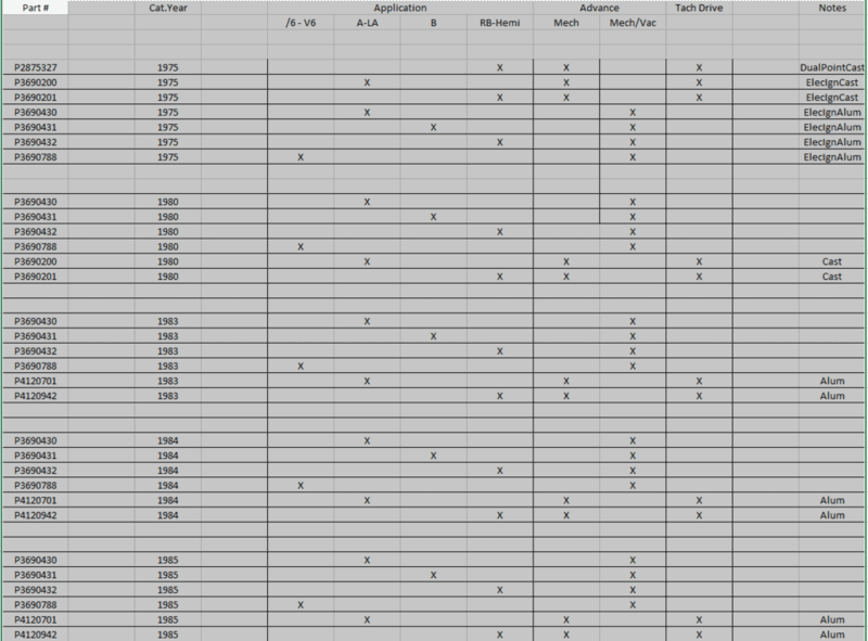

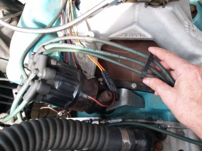

MP distributor, Got a pic? Looks like the same as a 201, they did that with the numbers. Prob a rb mech advance tach drive.
It's a direct connection piece with the slip joint on the bottom for reduced spark scatter. 2 wire electronic.
He sent me a pic and tag says "83" for a date code.
Date codes on them are funny. Same number can be ten different years.
Thank you guys for your help odcics2 nailed it , it was from a old USAC car.
