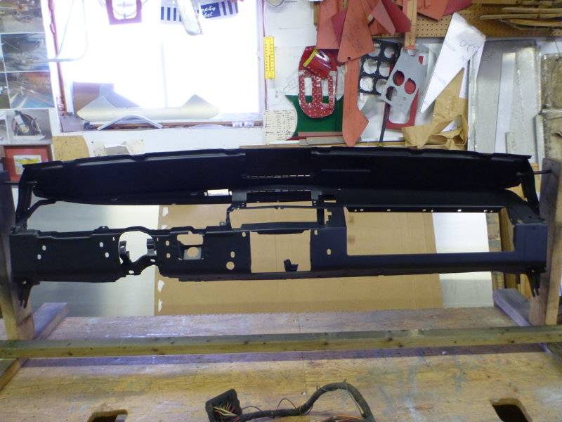

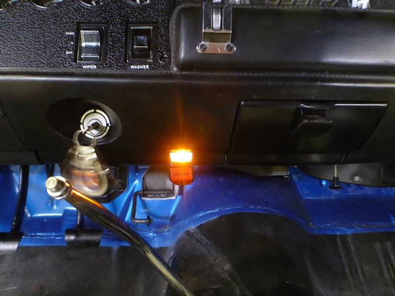

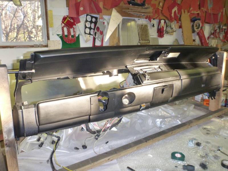

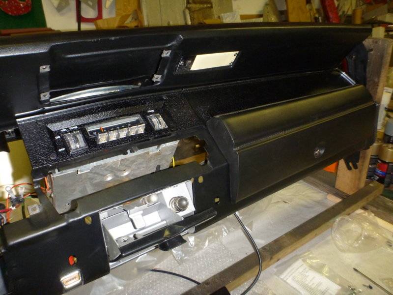

There would have to be a big plastic plug if there was Roger. Hole is below the pad. Here are some good shots showing hole location vs the slot/oval for the pad screw.

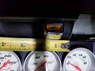

Almost forgot. Center of light is 2.25" over from the ash tray edge. Now you let me know if I have the hood cable in the correct place..

Same as what I'm showing. Hole is in metal dash frame, not in the pads. Light sits right below the pad. Why I said he'd see the hole if it was there, they'd have to plug it.

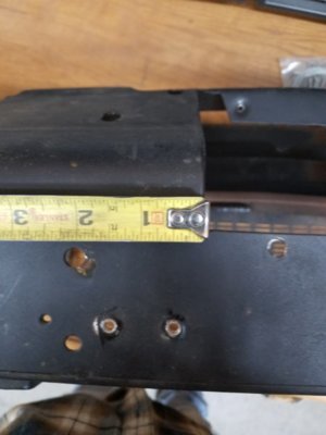

Well, now I am really confused. The pic of the bare dash is my 69 Bee with the original carb air cable mount at 1 inch to the left of the left ashtray opening. The other pic is my 69 Road Runner original 4-speed car. The reverse light on that car is 1 3/16" left of the left side of the ashtray opening. I would not have thought the reverse light would be in a different location Dodge/Plymouth. Unless it was moved a bit if a car had the fresh air option? This is why I am dragging my feet on drilling a hole in my dash.
