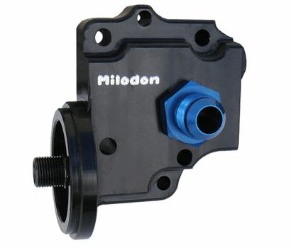

Long story short, the wrong Milodon oil pan was imported into the UK for me. I've got the 31581 Pro touring pan that has the external pick up option instead of the 31580 internal pickup, and given the hassle and cost to return, not to mention how much I'd be out of pocket by the time all is said and done, I figured, why not make the best of it, and upgrade to the full external oil system?
I already have the Mellings high volume oil pump, the longer oil pump drive shaft, and seeing as the have oil pan, the way I see it, I only need the 21215 oil pump cover with AN-12 port, an AN -12 oil line, and longer bolts to bolt the cover through the pump and into the block. Is this correct?
I ask because the single line pump "kit" is $475.95 before shipping, whereas I can pick up the 21215 oil pump cover for $360 and get the AN -12 Line and fixings, and longer bolts over here in the UK.
Sounds like a lot of effort, I know, but with Milodon saying that the full kit is on back order until the end of July at the earliest, it makes sense to me to just get the cover, and cobble together the rest over here...
Let me know your thoughts

Unfortunately I have the 31581 which is external pickup only hence the need for the pump cover and hose. The 440 source one looks to be a superior product, and at $160 cheaper than the Milodon looks to be the way I'll go.

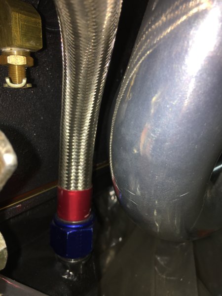

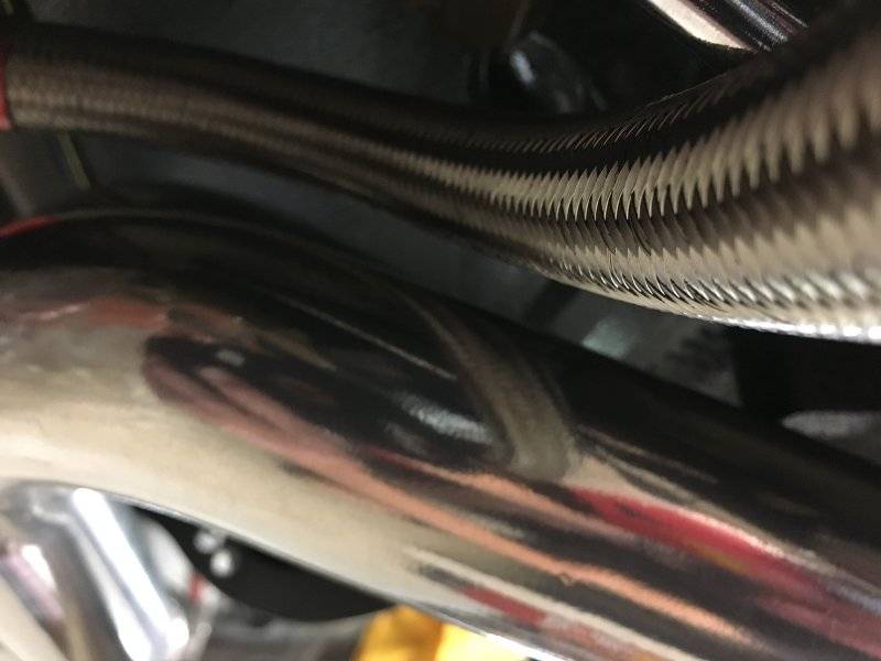

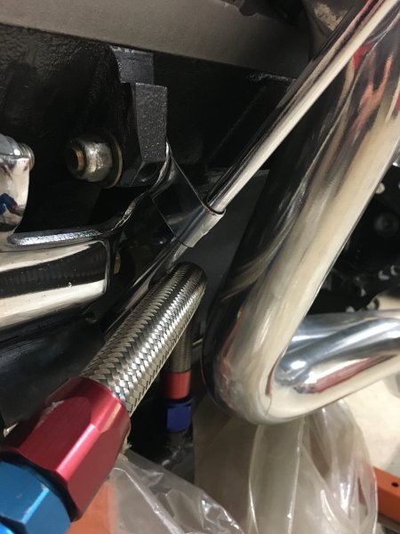

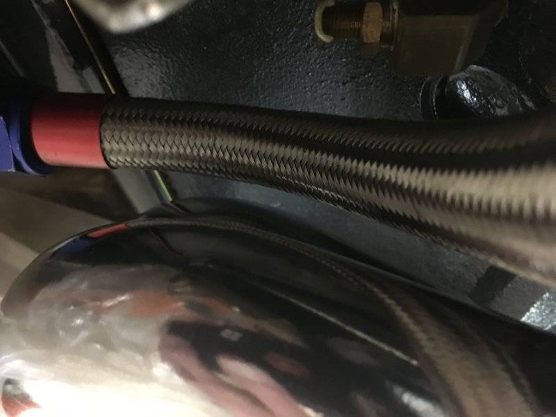

Here are some shots of mine. The cover was made a few years back by "Muscle Motors". My headers are "Dougs" D452. The line is VERY close to the header. After these photos I swapped the straight connector at the pan for a 45* to take that big loop out of the line and to shorten it a bit. I also bent the dipstick tube to get a tad more clearance. Keep in mind this also has to clear your steering box.
I wish I'd had one of the old Milodon plates that go between the pump and block to see if that would have worked better - or the pump portion (both shown in the last photo.
