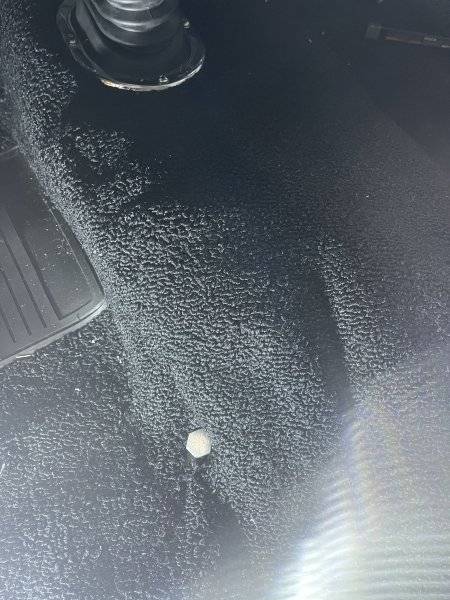

Anyone else struggle with ACC carpet?
Ummm, remove the already glued jute? Then glue it back? Then steam?
Not only am i confused, i don’t own a steamer…..
seems to me if ACC brags about being the best, they need to provide a carpet that fits right
I just removed the jute that was bunched up. Used 3M spray glue and "reformed" using weights.
Glue the jute to the floor, not the carpet. Rent or borrow a steamer.
Just got off the phone with Rock Auto, they talked to ACC, and are sending yet another carpet out….
Maybe by Thanksgiving ill have this machine running!
Call ACC with your order number and request the carpet not be glued to the jute.
