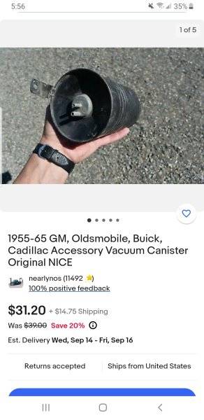

This one here is closest to what your charger would have have. Years ago when I had my 69 charger, the can was rotted, so I cut the end off with the valve, and glued it to a V8 juice can with JB weld, and attached it to the bracket. Bracket on this one may not be exactly correct, but the valve type, and length is correct.

If it's for a 68-69 charger, that one is a bit short in length. Also the one hose nipple that pulls initial vacuum from the intake manifold needs to be larger. The oldsmobile one I screen shot is much more closer for 68-69 provided that is the year charger the OP has
No it's off a 71
