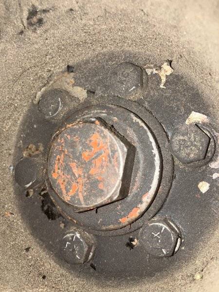

My untimeable motor.
10BTDC is the line AT the 10. Where is your’0’ TDC mark on balancer? I see a bunch of lines in your picture. You need to mark the TDC line on balancer with chalk or white grease pencil.
It's a bright white line under that black line and piece of tape at the very bottom. I placed some tape there with another line at 2.36 inches counterclockwise from the TDC mark to attempt total timing.
If the white line is TDC. I believe your timing as is would be approximately 40* BTDC.

If the idle speed is close to what it was set at the issue is inside the distributor. What this video for disassembly
Doug
To verify TDC, Use the piston stop method and mark the Harmonic Balancer.
This will establish true TDC without removing the head and using a dial indicator.
Also check the Harmonic balancer for slippage between the inner and outer sections.
This will cause extreme swings in the timing marks.
