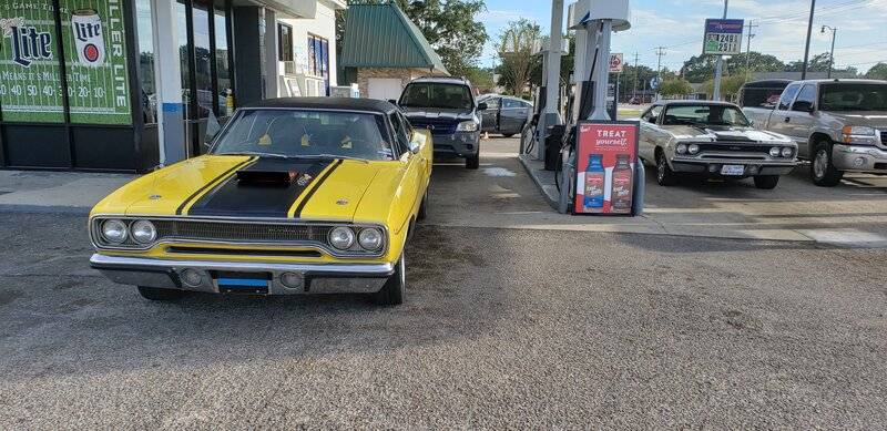

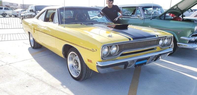

I am going to need about a 5" high cowl the width and depth of the normal power bulge for my 70 Roadrunner.
I have been looking at fiberglass, but by the time I get it paint matched, I could get a carbon fiber hood. "Natural" dark gray/black with that beautiful deep clearcoat looking epoxy...

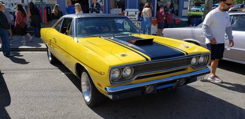

I'd also like to see what it would look like with the satin black factory stripes.
Thanks in advance to anyone who is kind enough to do this for me.

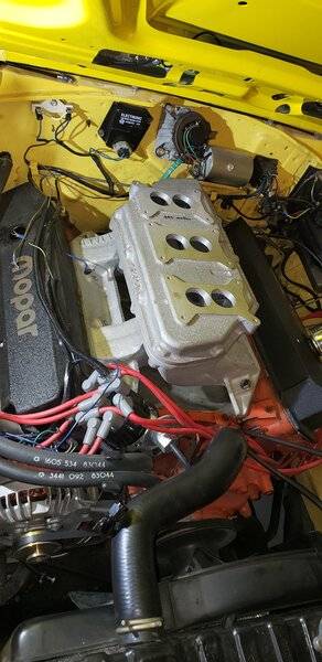

The biggest reason why I'm doing this is so I can incorporate the Air Grabber setup and airbox with this Weiand 6bbl intake.
Some pix you may be able to work with

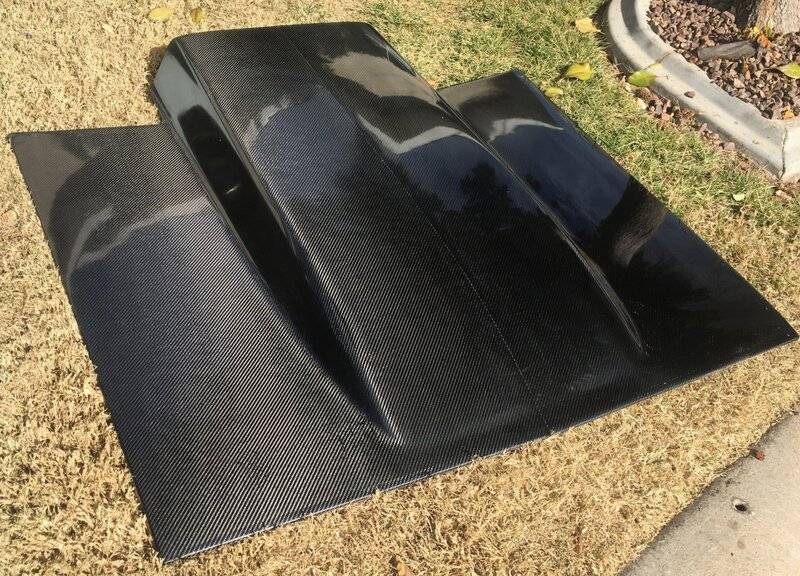

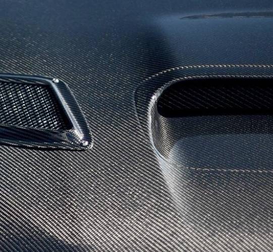

What I can do maybe is see other work that they have done. It HAS TO BE nice, and the kind of "color" and "finish" I'm looking for is like this:
Now I don't expect it to be "Speedkore Evolution Charger" nice, but I don't want a funky, blotchy, wavy piece of **** either.

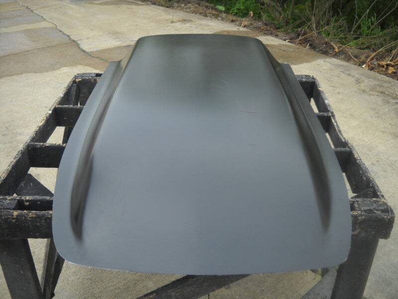

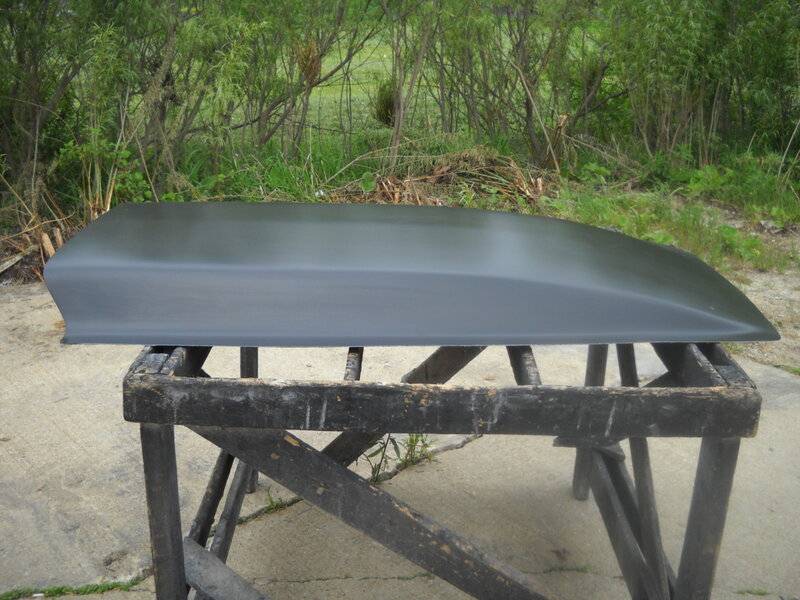

I emailed Glasstek. They have a couple of "cowl" scoops that look ideal in that they do NOT have a center line, which is how it must be because of the Air Grabber door, at least flat except for the very front, which is like the factory hood.
The CF hood pic is the finish I want, and similar to what I'm thinking about.

Glasstek OTOH was very friendly and enthusiastic. They have pictures of a couple of good scoop candidates, FLAT top with maybe a little center line peak right at the leading edge of the hood, just like the factory hood.

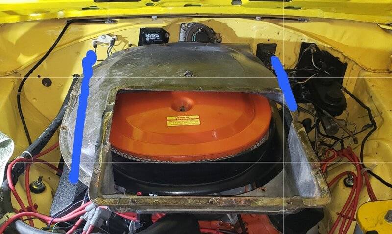

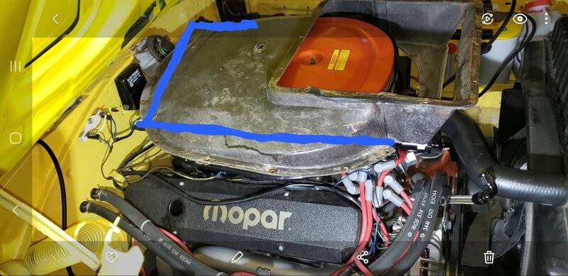

That is why I'm looking at what they call an extra wide cowl, which isn't terribly wide, but it has to be wide enough to accommodate the tallest parts of the airbox, at least part of it. I am going to mock up and measure as much as possible. Take a look at this, the blue lines:

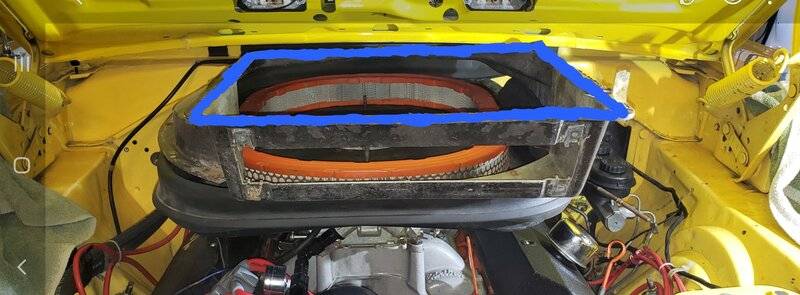

This blue line square is the part that attaches to the hood frame for the air door:
And the upper (higher) parts of the airbox will have to have space in the cowl:
And I still need space for the vacuum can and actuating mechanisms and flap that blocks/opens the rectangular opening to underhood air. If need be, I may be able to use one or two small electric motors to lift the scoop and open or close the metal rectangular flap.
The BEST scenario is to be able to use all of the factory parts, not reinvent it, but make it work with the cowl. I have to be able to mount all of those parts as well.
It's a bit much for me to wrap my head around at this moment, but PLEASE keep the suggestions coming!
