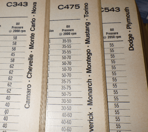

The MP book is basic at best........
Even old manuals such as this conveyed just general numbers. These were for '69........
That's weird that Fords are all over the place as well as GM's. Mopar must have had their squat together to have a constant 55 across the board.
