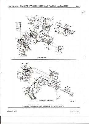

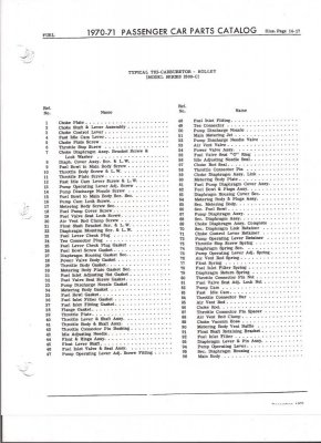

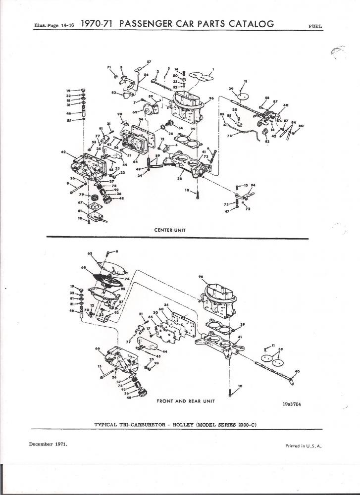

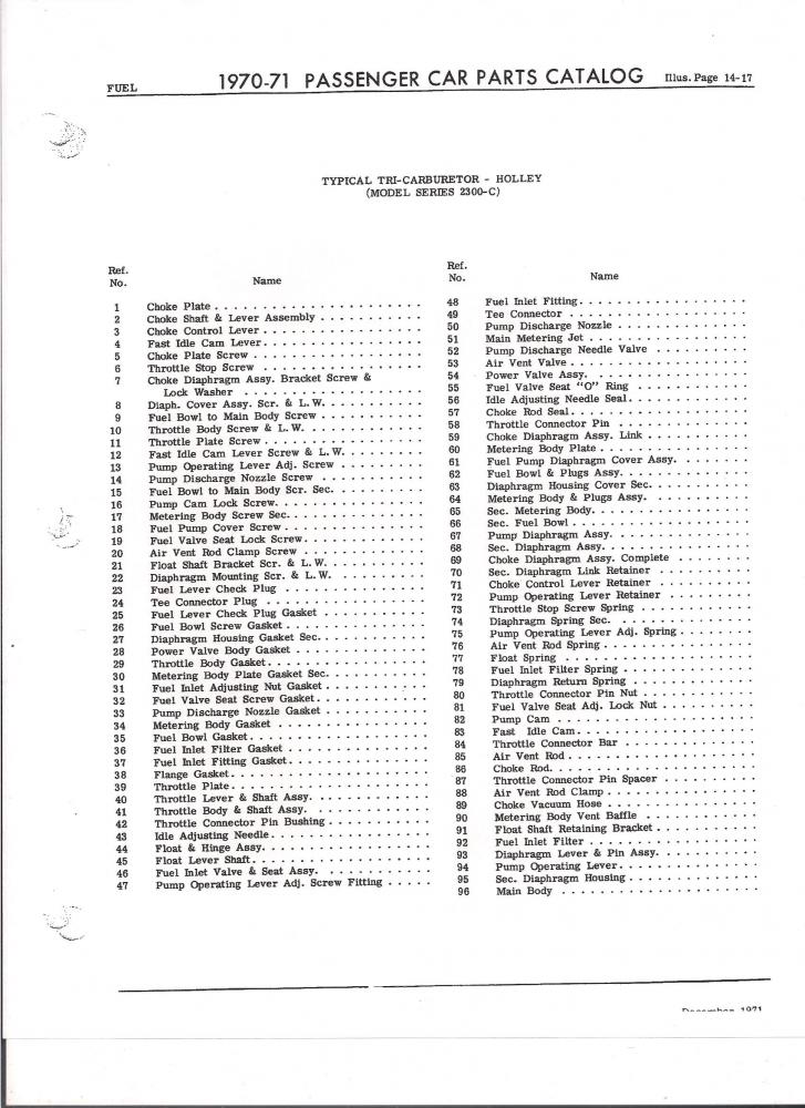

I know this is a crazy question to ask, but I was hoping someone out there had the service catalog or parts pages for a 70 six pack setup (though I imagine all years would be the same).
I don't care about originality as my car is a 67 with a non-original 383 and the setup is off a 340 a-body! I just want to replace all the damaged, stripped-head bolts in the 3 carbs with hex head bolts as well as add a little custom style while I am rebuilding it this winter.
