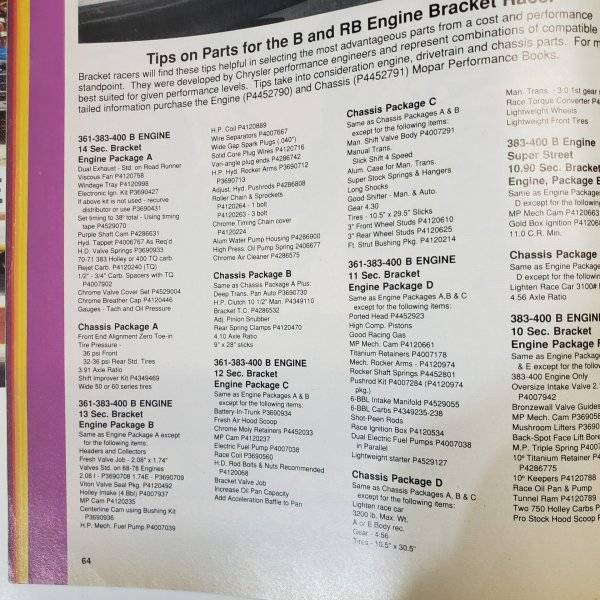

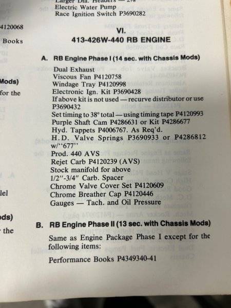

As title says, anyone have the old direct connection builds for the 440s, where they list the bracket ET and then the parts? I have the one here for the B Engines someone sent to me

Guy who sent that photo to me said it was from the mopar performance manual from 1990.
Would you be willing to part ways with either some loose leaf DC or a bound engine manual, or post some pictures of whats listed?

The recipes work - pretty good, actually.
The all-steel wagon shown in my avatar was built around the 12 second recipe and routinely ran 12.50's.
Stock '70 440 rotating assembly, 284/484 purpleshaft, ported 906's, M1, 750 DP, "J" converter, 4.10's. Did it all on pump 91.
The recipes from Direct Connection actually worked well in the day, and still do within reason. Today's fuel makes some things obsolete unless you go with 100LL or racing fuel. I choose cams and head work from someone that knew the current science of the day and invested heavily there. Then there was the recommended things from the catalog, such as anti pump up lifters, better rod and main bolts, windage tray, bigger carburetor, etc, etc. Drivetrain wise, I fixed and improved items as I broke them.
