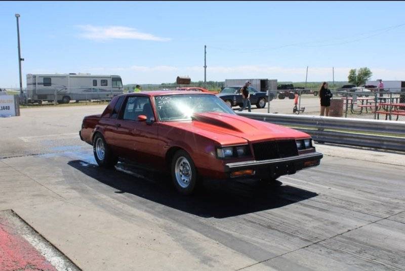

I bracket raced a friends 85 buick regal a couple weekends ago since our car wasnt ready. The buick has a 377 sbc and 3.73 and is a upper 11 second car. It has iron heads and a hydraulic roller cam, nothing special...but fun. It's a good example of having fun with a small block..even if its not a mopar.

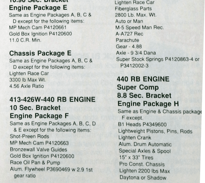

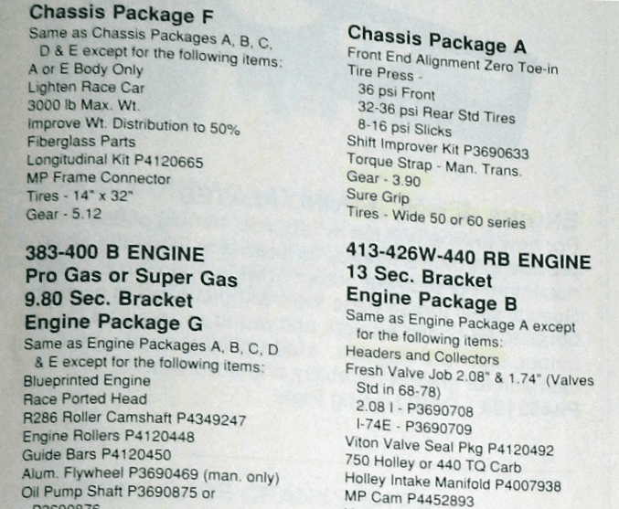

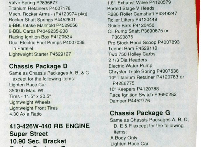

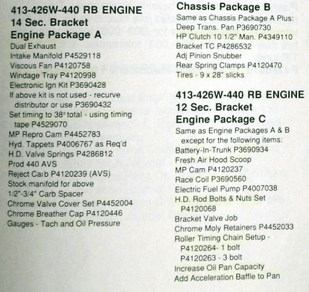

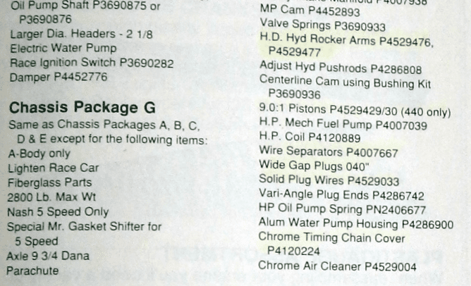

Eh i have mandrel bent 2.5" to the back, and will install cutouts and probably move to a 3" system. It'll be as close to open headers as I can get to without being pulled over. Also cant let those machine gun tips go to wasteThe old recipes are nice for a drag car (I think they assume open headers?), and really look at the required converter, gear, tire, chassis parts of the "recipes".
