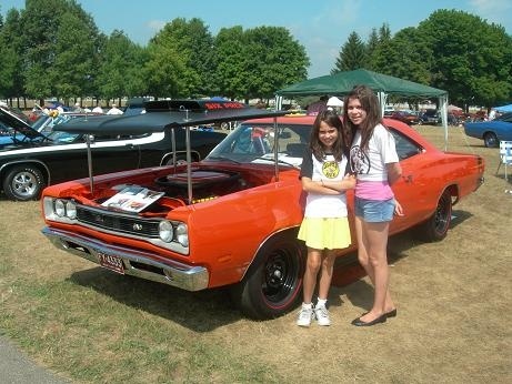

http://a12mopar.com/yabb/Attachments/hood_props_001.jpg
Hay that last pic is my bee. Here's another pic. The poles are 22" tall.

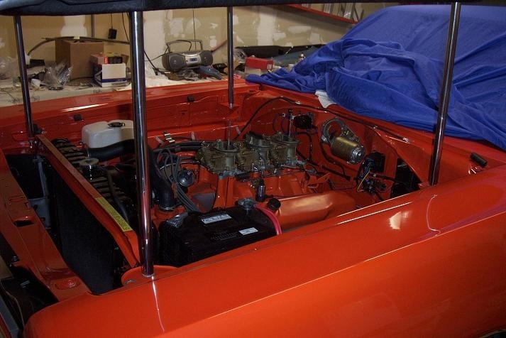

Where did you get the poles?
I located stainless tube and my buddy welded the pins on for me. They are a pia, but I don't put the hood on the roof anymore. Takes two people to put the hood on the poles. I usually just put it on the ground unless it's an actual show. Here's the only close up I have.
