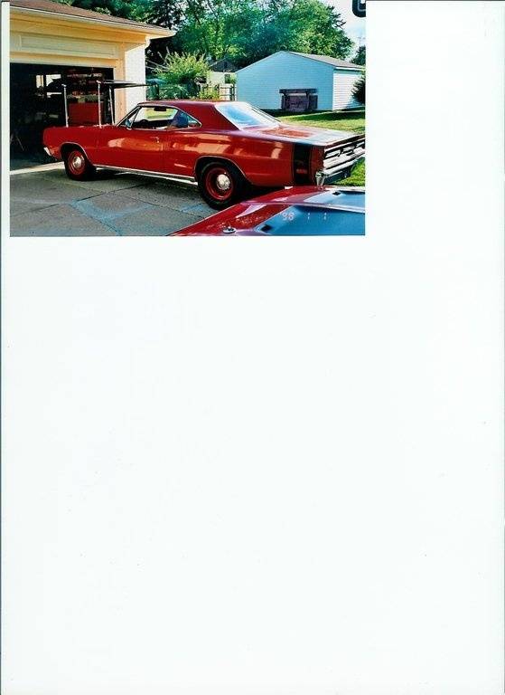

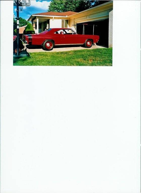

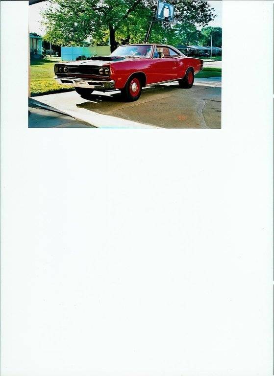

I made mine out of a clear 1" dia, plexiglass rod. I drilled & tapped one end to thread a set of factory hood pins into & bored & polished the I.D. of the other end to slip over the pins on the car. The hood appeared to be floating. I eventually cut them down to be a little shorter.
