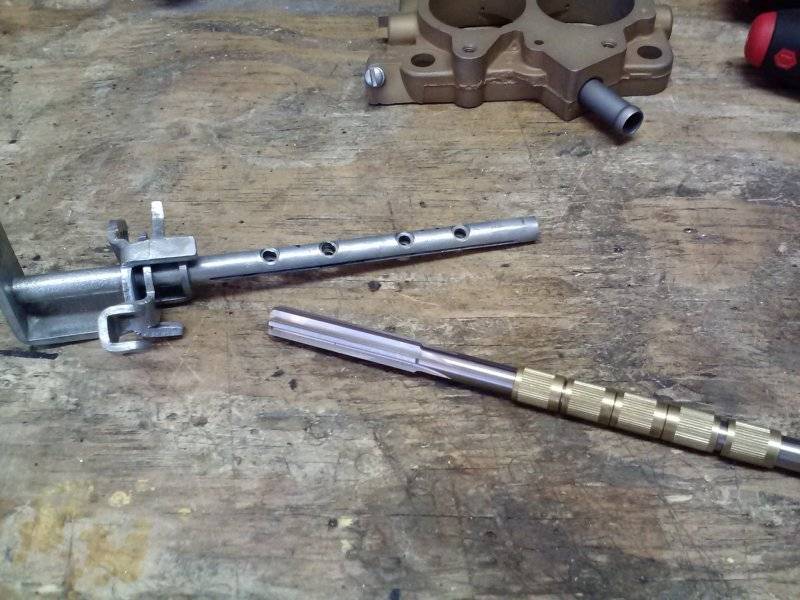

I need to put bushings in for the primary plates on my 66 Hemi carbs as they are leaking out on the manifold. Quadrajet Parts makes an installation kit for 3/8” bushings. But their screws are incorrect for an AFB.

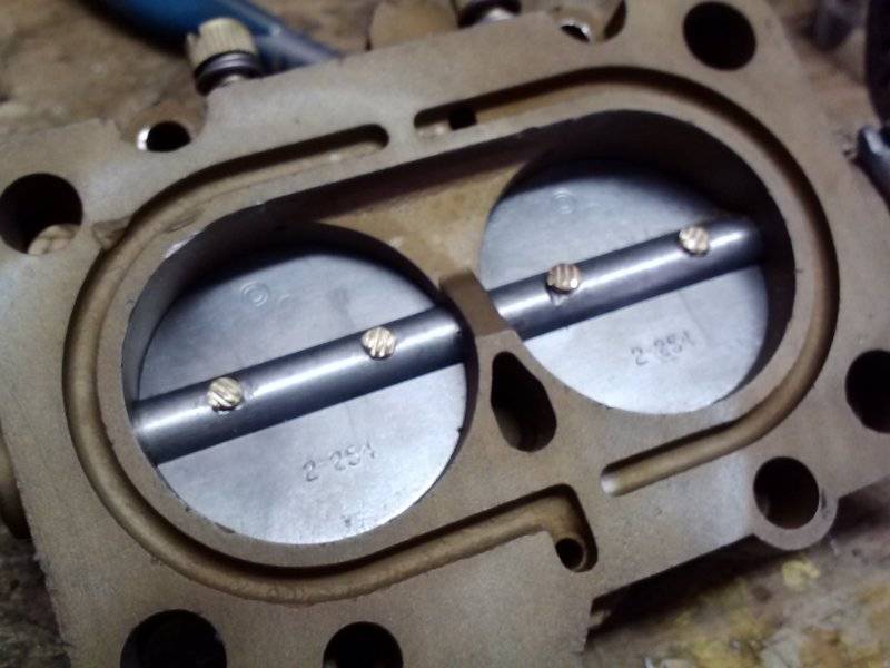

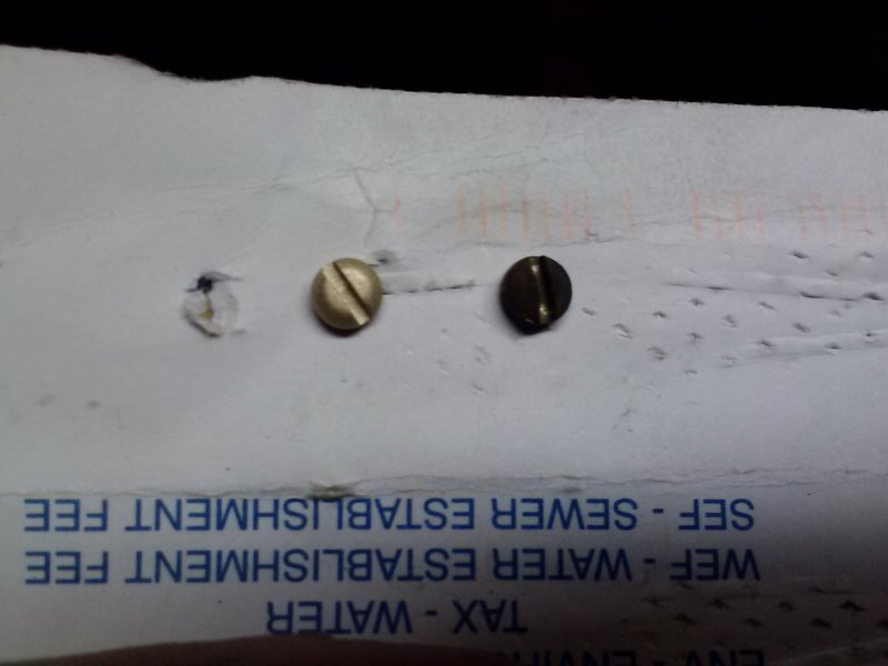

The Secondary uses a 6-32 5/16" and the Primary a 3/8". They are fillister head screws not flat head. Do need to file peen off to remove and be slow about backing out. Out, then in, file more until come out nice and easy. If they are center punched I do drill the center punch first to remove material.
My Carter BBD had #6-32 × 3/8" screws. I turned the heads in my drill to get the right profile. I checkered the face of a punch to mimic the factory screw lock.
