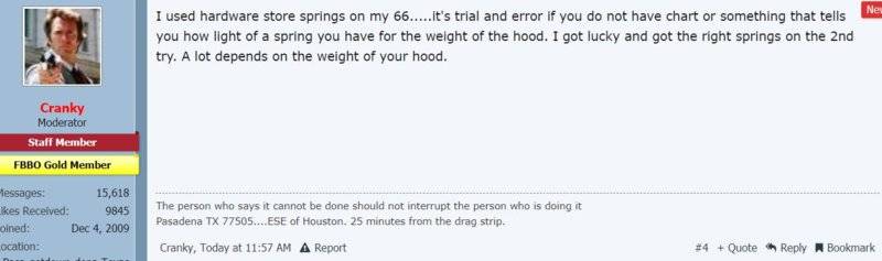

I used hardware store springs on my 66.....it's trial and error if you do not have chart or something that tells you how light of a spring you have for the weight of the hood. I got lucky and got the right springs on the 2nd try. A lot depends on the weight of your hood.
