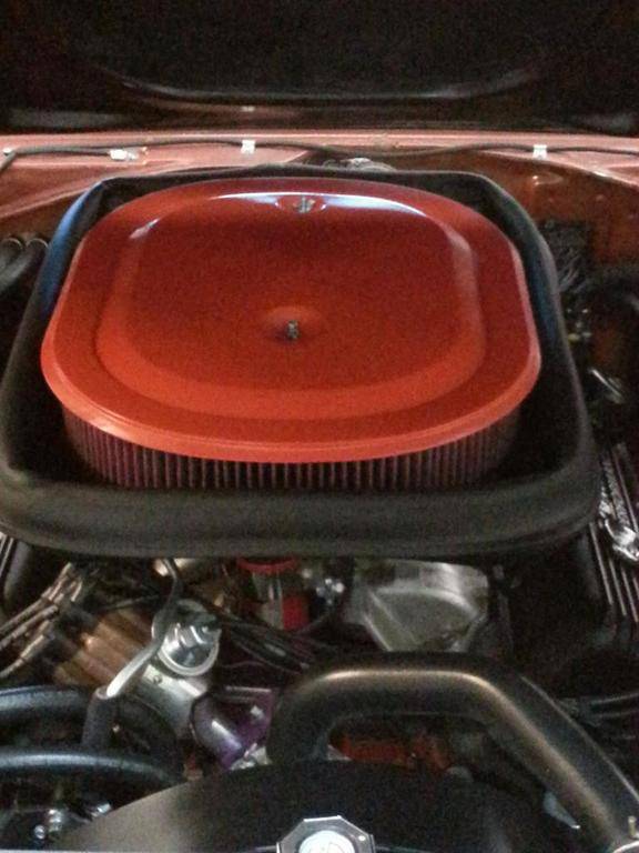

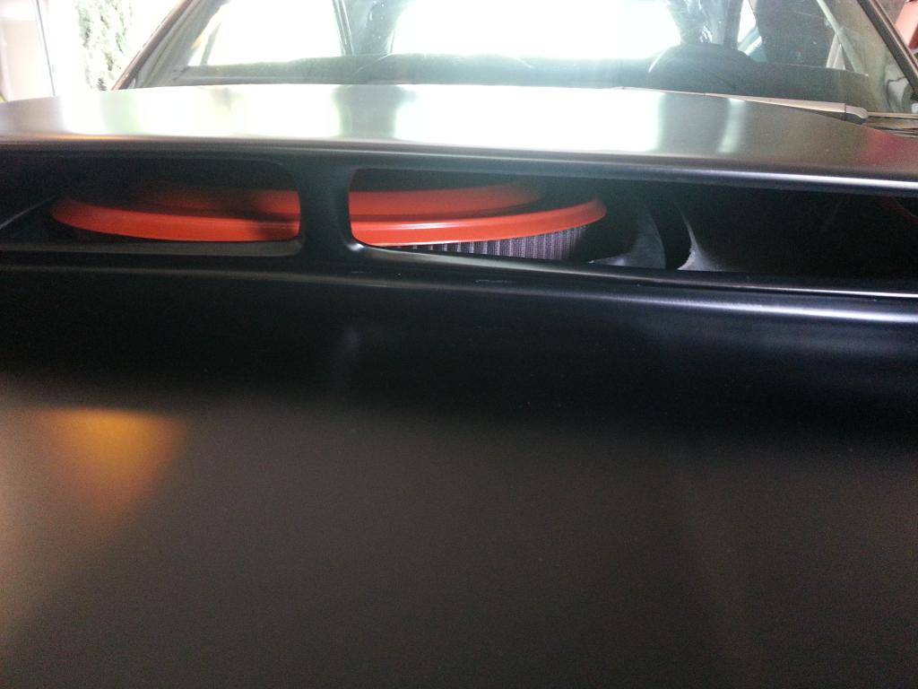

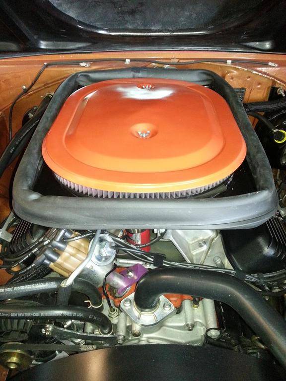

hybrid call steve, he sent me a pretty rough one but I finished it off best I could at least lid is fiber too. just need to fix my hood cut out underneath it's center and not offset like it supposed to be. note when buying lift off hood, make sure you buy one with a offset opening on the underside!!!
First pic is the 2" k&n filter, last one is a 3" it works much better
Can't give you a breakdown of the price as the base lid and seal were all together for $445. You would have to email Steve at Hybrid fiberglass for specifics. The base will be fiberglass not metal, a metal lid is like $1300! I did have to do some prep and pain to the bottom of the base and paint the whole ting which kinda sucks for me cuz I totally sick at that stuff.
