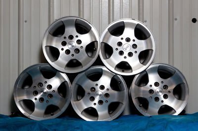

I'd like to put these on my 74 Charger:
LH wheel bolt pattern is very close to the old standard MOPAR, I've read/heard that you can use 'em on the old cars, but, to me it looks crappy! The offset is very different, to me, they just don't look right.
I think the NEW, new pattern (like new Charger/Challenger) is quite a bit smaller.
They made/make a lot of differnt style wheels lately, sometimes 3,4,5 or more per body style, per year. Different sizes, offsets and styles. My "favorite" U- pull charges $25 each.
Those LH wheels had NO issues as far as having to force them or the studs being tight. the offset didn't look bad, either.

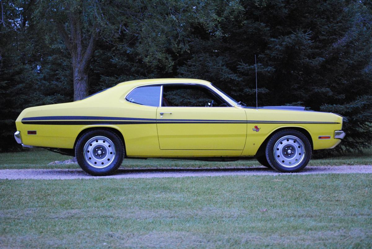

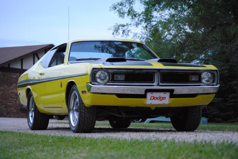

Gdemon over on FABO runs the ones I want to use on his Demon....
I believe he used spacers on front and a wider b-body rear. I dont want to replicate the ralley look just black with chrome lug nuts. Not a long term deal for me just have access to the wheels and tires on the cheap. Even if I have to buy spacers it'll still be way less expensive than a new set of 17's, well any that I want.

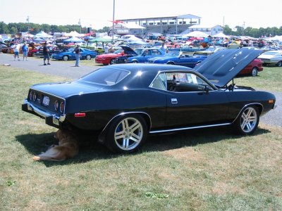

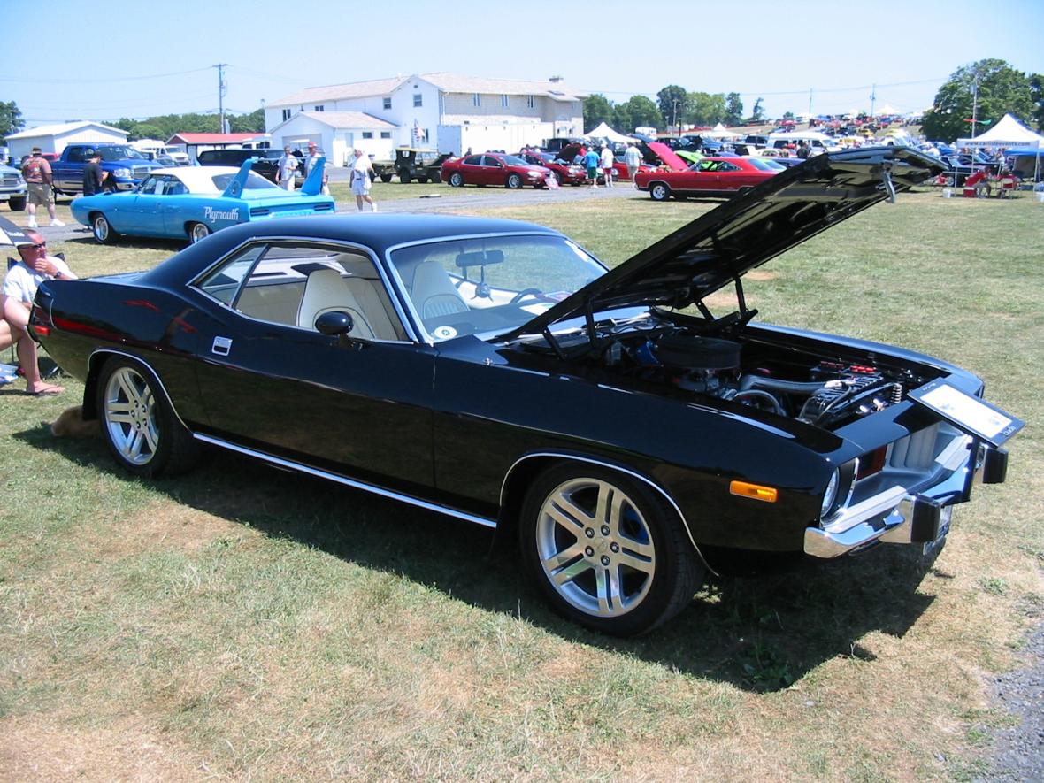

Heres a Cuda I saw at Carlisle last year with 18" 05 Magnum RT wheels
