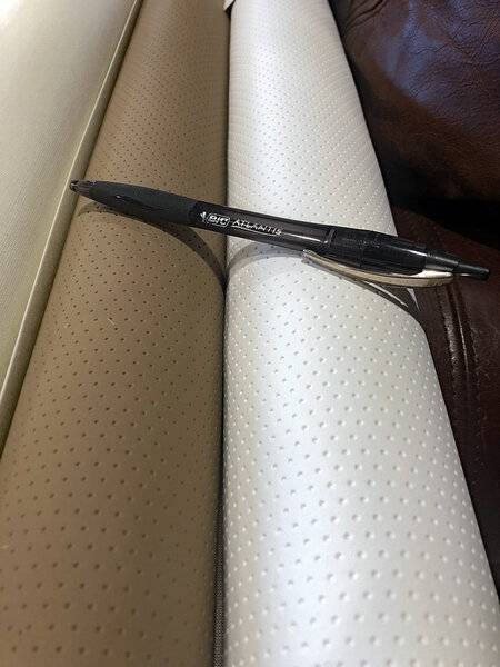

I plan to recover my original using one of these two vinyls... I haven't decided which one I'll use yet. Less than $20
At least that's the current plan until something better comes along.

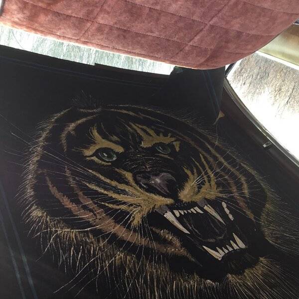

Maybe you would like something like this.
That reminds be of the fuzzy posters that you used black lights with.
