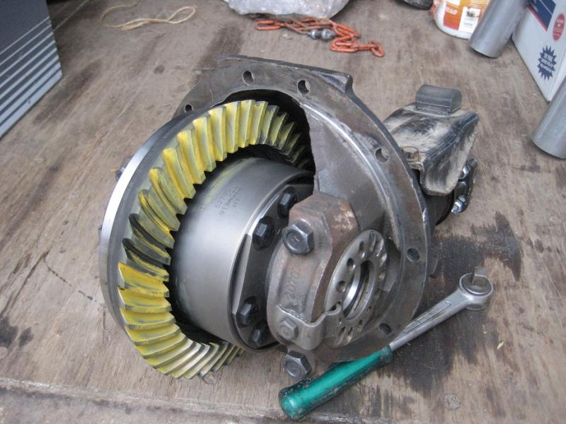

Put one in my 68 super bee when i changed the gears to 3.73's, but haven't put much more than 15 miles on it since then because of an unrelated electrical issue....went in ok, no issues so far as far as noise or anything. I'll let you know once i get some miles on it...

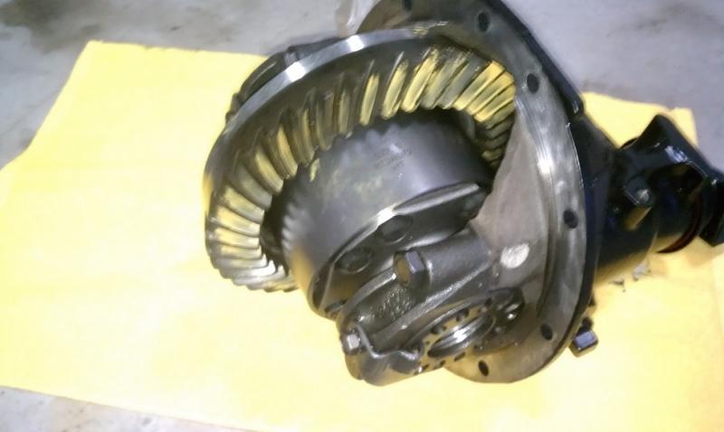

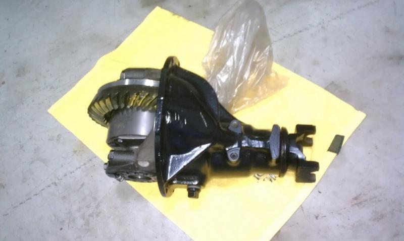

Got mine back today, True Trac with 3.55 gear. also upgraded the collapsible spacer to a billet steel one that is shimmed so no preload on it. Probably overkill for my 340 street motor, but hey, it should never wear out!
