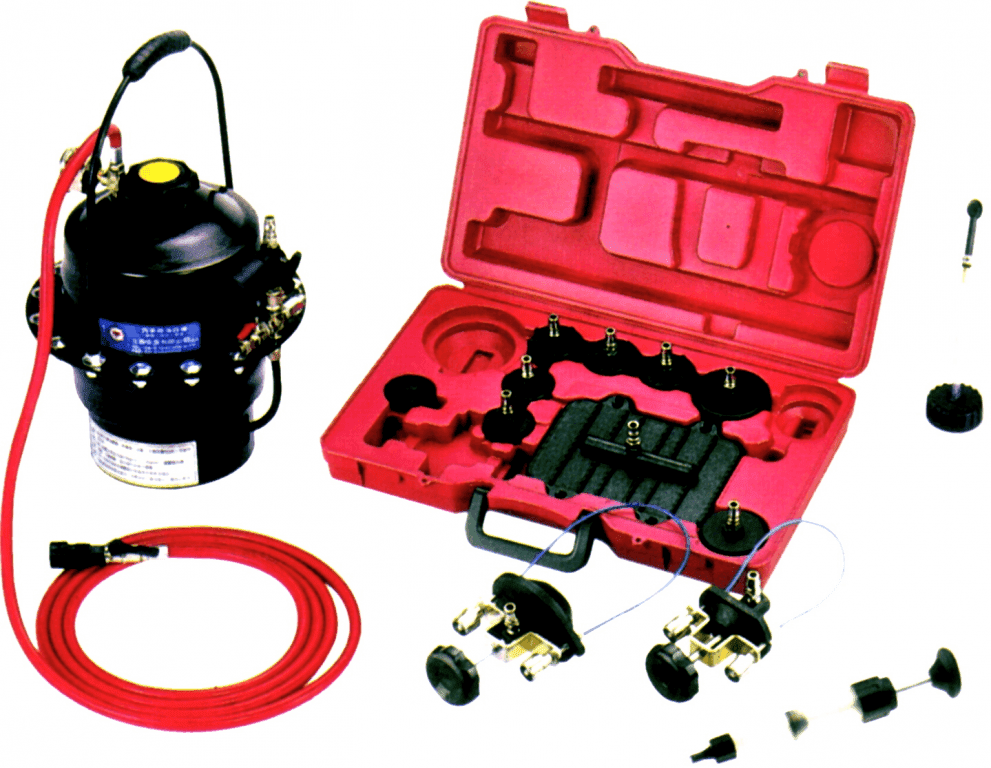

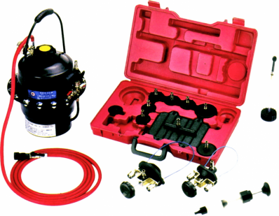

anyone use one of these for brake bleed?
I've used one many times on my cars and friends cars, they are easy to use and work great and you can do it by yourself (bonus). You will have to remove some brake fuild from the master cylinder first because you will be forcing brake fluid up to the master cylinder to remove the air that is trapped in the system. Air want to rise. It takes about ten minutes to do a car. Just a reminder that you will have to remove some of the fluid in the master cylinder as you press more fluid into the master cylinder or you will have a mess, once completed check to see if you need to fill up the brake fluid in the master cylinder.

Bought a pressure bleeder a few months back. Works great on new style MCs, not so much on the older cast ones. Had to fab a plate about the same size and drill/ tap for the hose to connect... nicesy part is you dont ever have to worry about running mc dry as the reservoir is 1 gallon..
another tip is to use slow even strokes on the gun, If you pump it really fast you are going to get a geyser of brake fluid all over your engine area (trouble). Mine has a attachment for new master cylinder bench bleeding and you can use it to bleed a new master cylinder while it is on the car to. i like to reverse bleed the wheel cylinder or caliper first, then I reverse the hose connections on the gun to pull the fluid down a couple of pumps to make sure there is no air trapped in the top of the caliper or wheel cylinder. You get a rock hard pedal with great pedal feel for the brakes. It is worth the investment and you can loan it to your friends to do there cars to.
