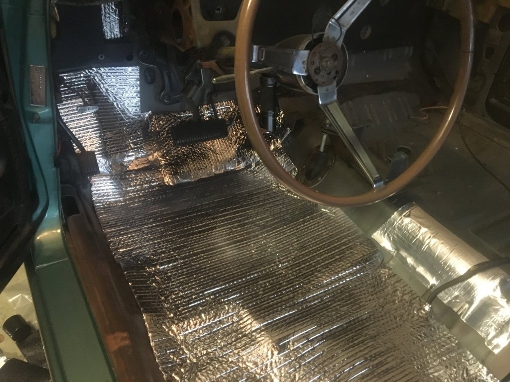

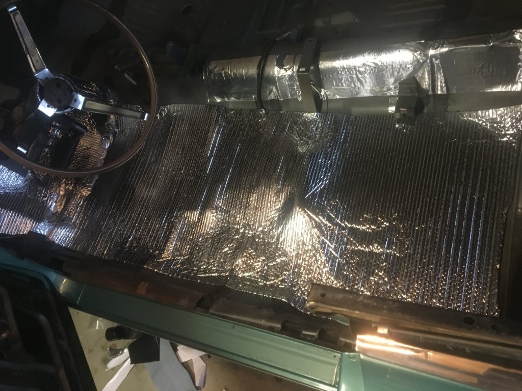

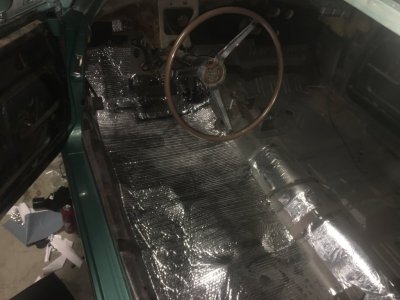

The ThermoTec foil topped butyl liner I just installed on the floorboard is very thin material. Anyone using some old school padding between that kind of "insulation" and the carpet? Thank you.

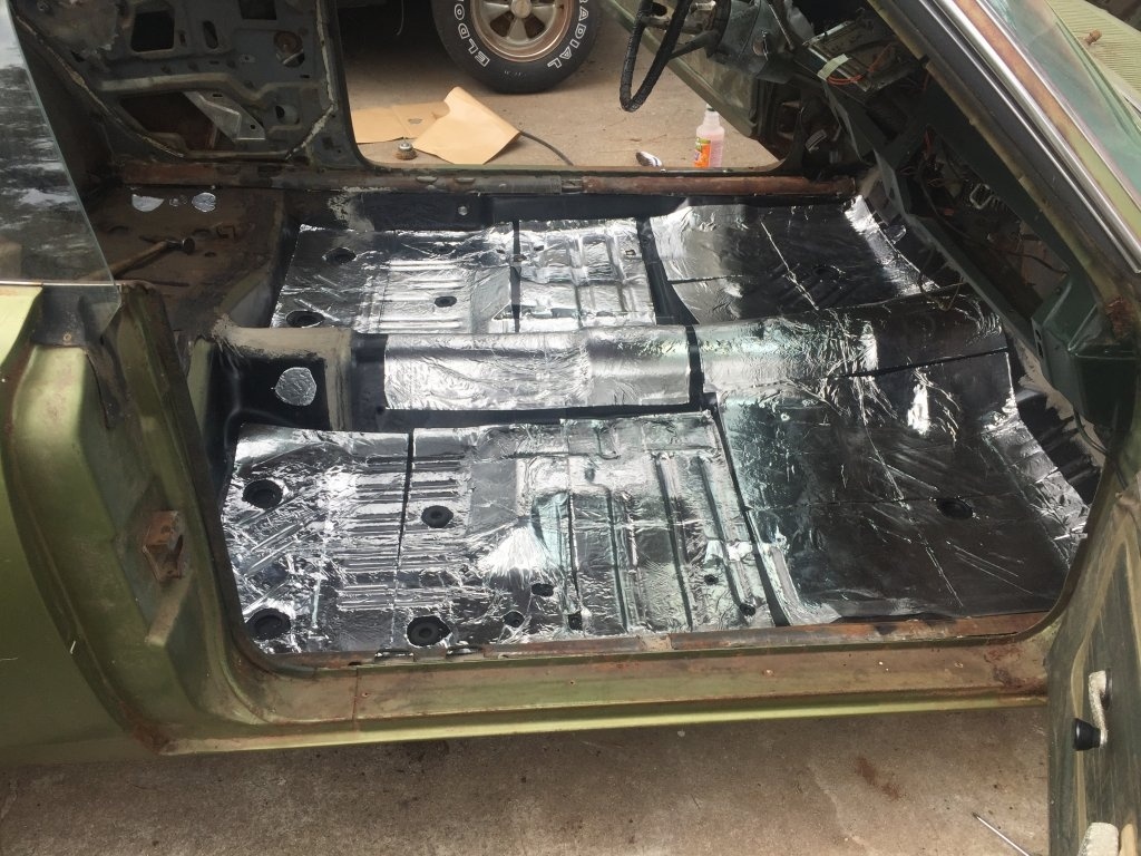

I cut out around the plugs so I could remove them if needed. As mentioned it does not have to cover every inch although I wanted more coverage myself.

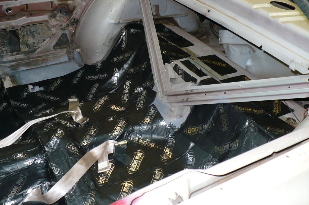

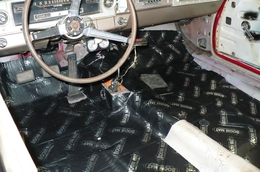

Agree full coverage not needed but have dronemasters...
