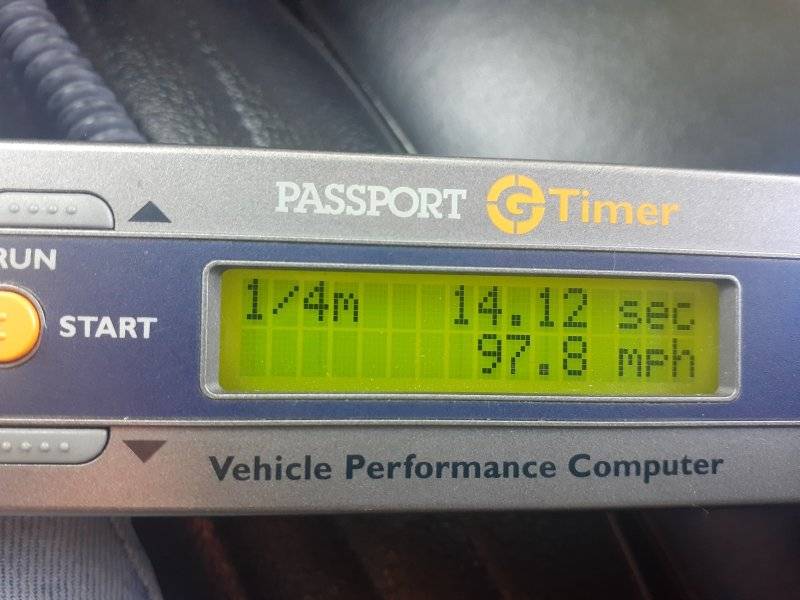

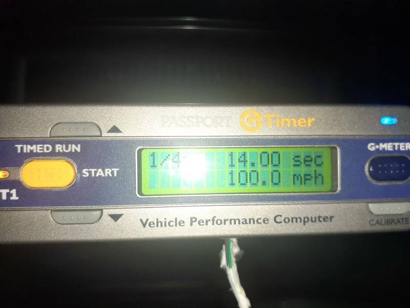

not happy with it yet my Newport with the same set up runs 2 mph faster and weighs 400 lbs more and stock 1.5 rocker arms. RT 2.94 gears no headers full tank of gas hot day with 77% humidity. if you think I am making excuses I am. it should be in the mid-high 13's. the g-tech went with me to the drag strip it had the same mph as the track but would read 1 tenth faster than the track times.

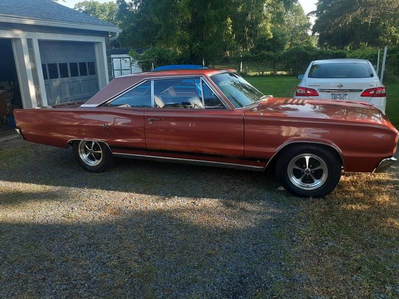

The car is beautiful.
I don’t remember the details of your engine and car, but that time and mph is what they did from the factory. Some were slower.
From a previous life. I did run 2.94s in it for awhile. It seemed no different than the 3.23s driving around, but never took it to the track with them

have to ease it out a little. I am going to do another test run because a few days before that it felt like low 13's. i wasn't thinking when I tested that day. have a couple things going on with it. hang on before judgement lol

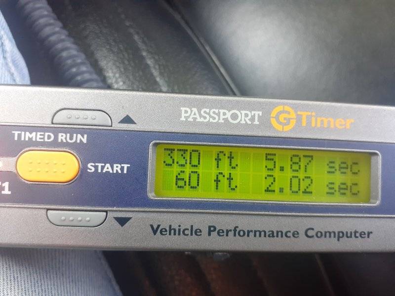

The 2.02 sixty ft suggests to me that his launch technique is pretty good for a true full-on street tire, his gear and converter.
If the tires break-loose, you’re usually in the 2.4 sec range.

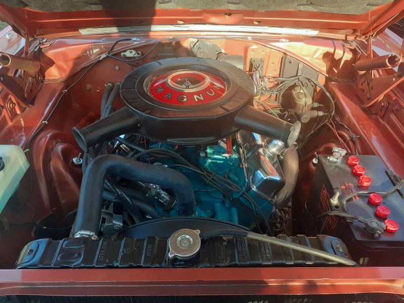

Stock intake manifold?
Any mods to it?

One reason I asked about the intake is, back when I was doing heads for some of the stock appearing guys I did a bunch of intake flow testing.
You could make some decent improvements to the heads, but after you bolted a stock intake on it, you could lose like 80% of what you gained in the head.
Based on flow bench results, the ootb RPM intake was quite a bit better than reworked oe manifolds.
The point I was getting to is……… if you’re running a stock intake manifold…….. it will negate a lot of improvements done to the heads.
l bought the heads 10 years ago never really looked them over. I know they have the 1.74 valve and 924 valve springs which I like the 911 spring a lot better. he said the heads were ported but not sure how much. when the intake was off I saw the intake runners they were just machined a little on the bottom no gasket match either. not sure on the bowl area. I bought the car back after 8 years after I first sold it.
With 516’s, It’s tough to make big improvements in flow, in the lift range of the cams you’re running, without resorting to bigger valves and/or a fair amount of porting.
I feel it’s because of the rather flat floor and low SSR height, which allows the flow column to start skipping across the back of the intake valve at a pretty low lift.
Once that transition happens, flow essentially ceases around part of the perimeter of the valve.
The taller SSR of the 915/906 can delay the lift point at which the transition happens.

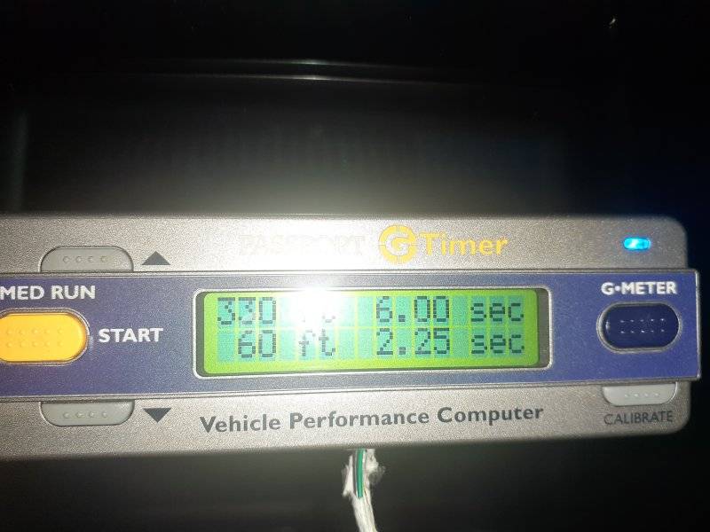

thought i was going crazy made 3 runs all low 14's felt like no power 2 second 60 ft times. going to call it quits but felt like more power on the way back. did one last run the power started coming back. I think because the oil had to warm up well and the intake had to get heat soaked. 15-40 oil. could never get an even 14 and 100 ever again lol.
