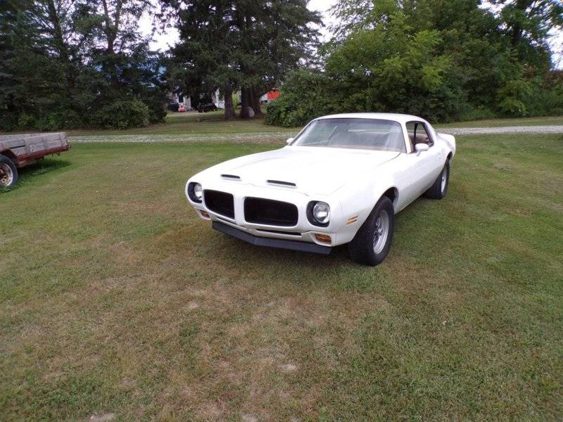

My neighbor wants me to swap engines from his 79 TA. It currently has a 403/th350 that run. I will be getting the th350 and 403. Might be stuffing a 454 Chevy into the car. Question is does anyone need this combo for their project. I know a 403 is a turd but for originality someone might want this stuff. I have the chance to swap this for a 4.8 LS with headers and after market engine mounts. I don't really need either setup. The 4.8 comes with the harness and computer but lacks the drive by wire pedal and throttle body.
