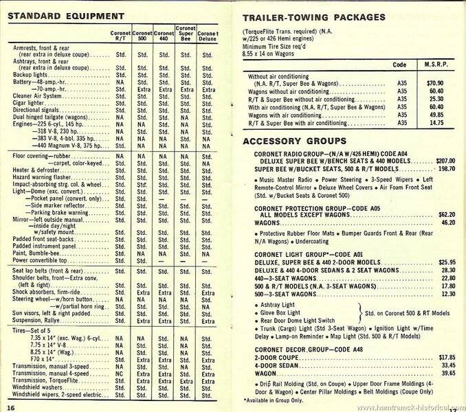

Do you have any documentation for this? I can't see a difference in 69 between a Super Bee with a 383 or a Hemi.
LOL...of course. :) but I'm not going to hijack the thread. It would be best to start a new topic. See post #23
The salesman's guide will not show the actual part numbers used nor the actual application like other documentation (broadcast sheets) will.
