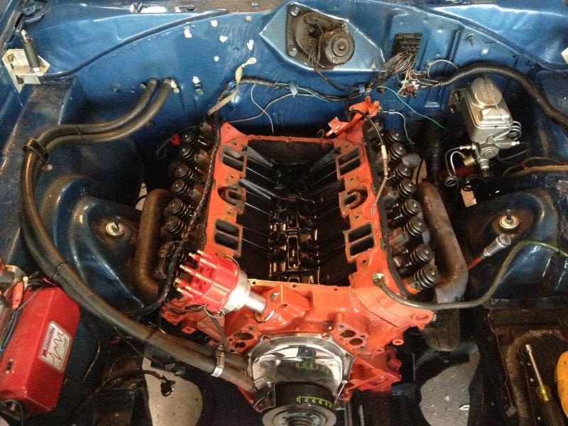

This morning I started to tear down the top end of my motor. Motor is a 1972 truck 413 that the p.o. said the owner before him rebuilt and stroked it to 452 ci., ported 906 heads, etc. this is my 1st rodeo, so I'm sure i'll have tons of stupid questions about just about everything.
So my objectives are:
1) replace the worn / stuck fuel pump pushrod and inspect cam lobe.
2) replace the rockers and shafts which were installed wrong and started wearing the shafts and rockers.
3) find out how the motor was built, tale some measurements and calc the compression ratio, etc.
4) Check out the cam and maybe make a swap.
Question: if i keep the current cam, i'd like to keep the timing unchanged. What steps do i need to take to be sure it's right on when i reassemble?
Thanks,
Dan

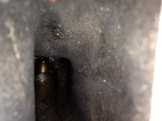

A pic inside the #5 intake port. Maybe later i just might get the head off.
My step by step as i go

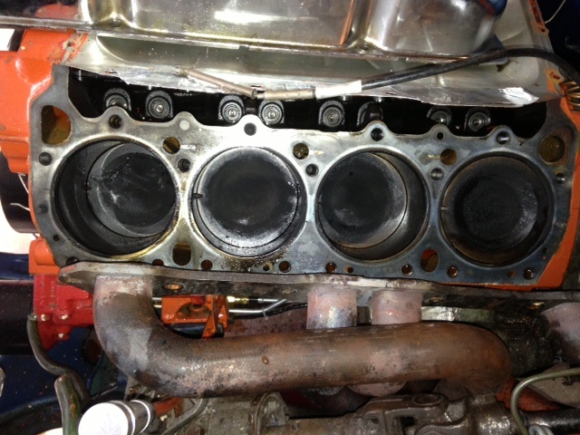

When talking timing, you have camshaft as well as ignition timing. I thought you were referring to cam timing, so just check your tining gear marks and re install at the same alignment. You can also degree in your cam, which requires a few extra tools and knowledge. I used to run a 413 in a 65 Belvedere, ran low 12 s at 5400 feet. Great running engine @13 to 1 C/R. Send us a pic of the piston tops at TDC when you get the heads off. And 452 cubic inches from a 413 block sounds odd. See if you can determine the stroke. It would normally be 3.75" in a 413 with a std bore size of 4.19". A 426 has same stroke but a 4.25" bore, a 451 has 4.375Bore.
Thanks for the timing advice. Well... let's just say I always knew it wasnt a stroker, even as the guy was telling me. Just didnt add up. The numbers, like you said, Gary. on top of that, it still has the original truck balancer. if it were a stroker kit i'd think they'd use another. Also, it runs strong, tears up 12" wide ET Streets through 1st and into 2nd but never left the line like a freight train, ya know? Plus the price i got the car at was probably right the high end of a stroker build.

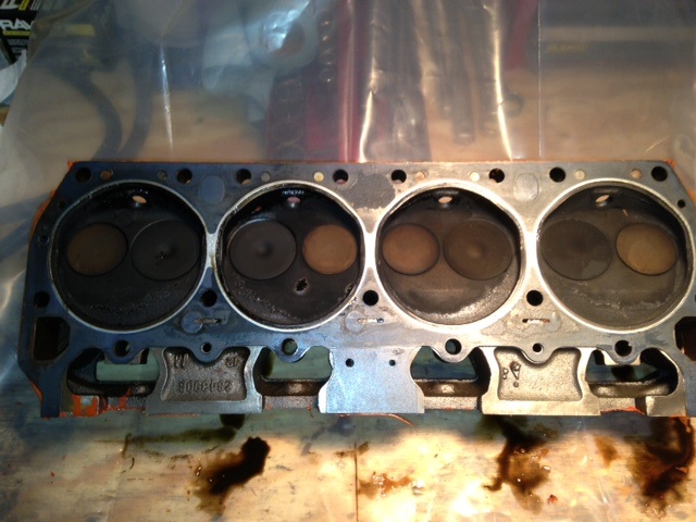

Well what i found... i just have to laugh.

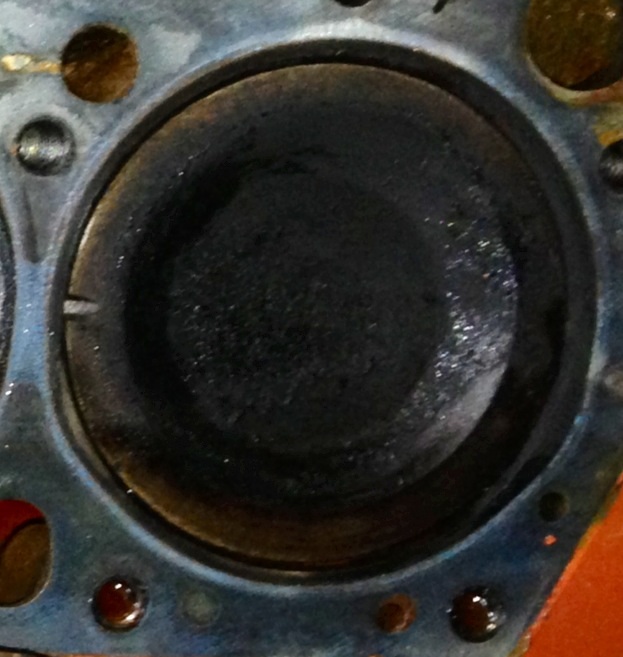

BEHOLD: the only stock RV short block paired with a 4000 stall converter.
Soup anyone?

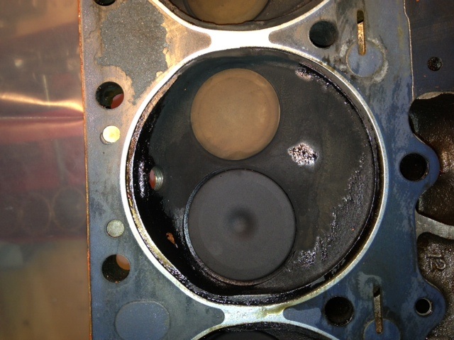

That one intake valve looks like it's sunk into the valve seat a good bit. I bet that guide is bad. Yeah, I'd say she's sittin at like 6.9:1 LOL
Right about 0.060 in the hole lol. I think I'll be in the market for a solid 440 short block here in a short while.

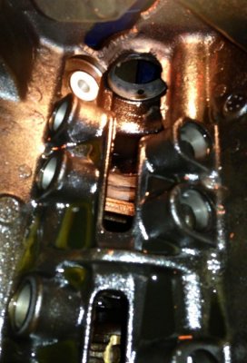

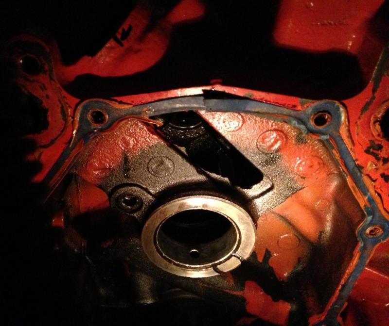

What do you think of this? Custom ventilation.
Damn. They are pretty much all like that under the timing cover.......but that area around the cam bearing looks strange. Did you get the fuel pump rod out?

Well......sorta. I would be worried if it was higher up say a rocker arm spewin metal or some such. But where it is......I think any metal would fall into the pan. Anything that got sucked up in the pickup would go to the filter first. You might be ok in that respect.
Good news is the Comp Cams rep said the cam is a cast cam and is completely compatible with the oem push rod. Maybe it's an old problem after all. Have a new pushrod and those mancini hard chrome rocker shafts and some gaskets arriving here in a few days.
I thought that was the case, but I was not sure so I didn't say. And just so you know, I looked at my 383 block in the same area as your front cam bearing area. Mine does not expose as much cam bearing as yours.....BUT, it is VERY similar, so I suspect that's normal. I wouldn't think anything of it. Run the piss out of it.
