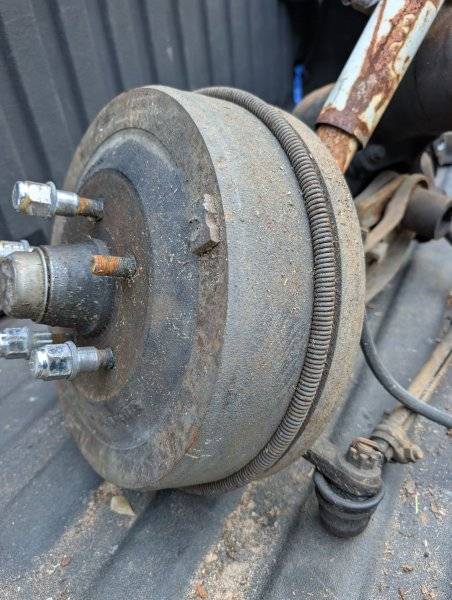

All, I bought another 70 K-Frame & suspension. Why - well honestly it's a bit of addiction :)
I spotted it online from a 70 Charger Big Block. I noticed the drums looked in decent shape and it still had the anti-vibration springs. I thought they'd be nice to have and a few spare parts and sell what I don't want to keep. Good plan right?
Well I checked out the drums and they seem to have life left and the groove for the vibration spring are rust free, so I bought it.
This morning while disassembling I noticed they seemed different than mine. Well duh - they're 11" drums.
So before I go and list them in the marketplace, is there any reason I should consider replacing my 10" front drums with them? My car goal is to put it back to original condition with factory/period parts where possible. Not a concours restore as those folks are on another level. I don't have a build sheet, but I think 11s on front and 10 on rears would be a giveaway. I also suspect the brake system is designed for 10s all around, but I'm not an expert.

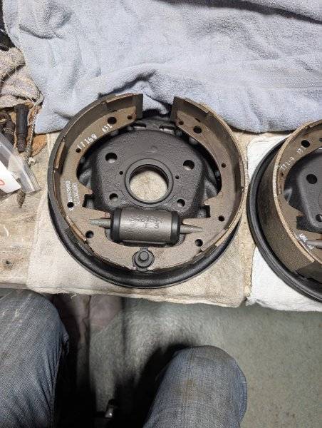

If you keep the brakes in post #1, new need a new rt hand spring...or bend the tang. It is about to let go. Nothing wrong with drum brakes, but I would fit self adjusters if you keep them.
