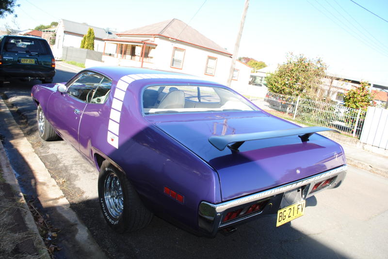

hi, my 71 roadrunner originally came with the V4W canopy vinyl roof , it was removed in a previous resto (before I bought it ). during this go round I'm leaving it off as well, but would like to collect the parts to put it back on "down the road" . so the question is will 1971 dodge charger canopy trim fit the road runner or do I have to look for road runner specific roof trim ? I have the slightly larger drip rail molding to ( just going to put duct tape on rail under it to stop rattle) already on the car but no roof molding or mounting studs ? . just want to know exactly what I can/ can not uses .

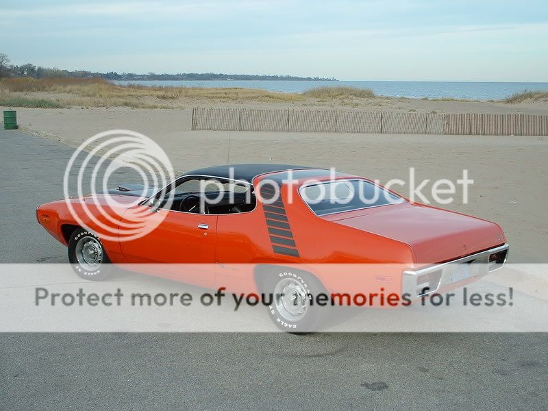

71 Plymouth canopy

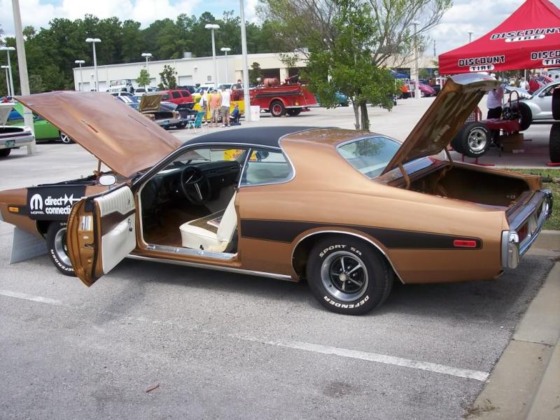

74 Charger Canopy

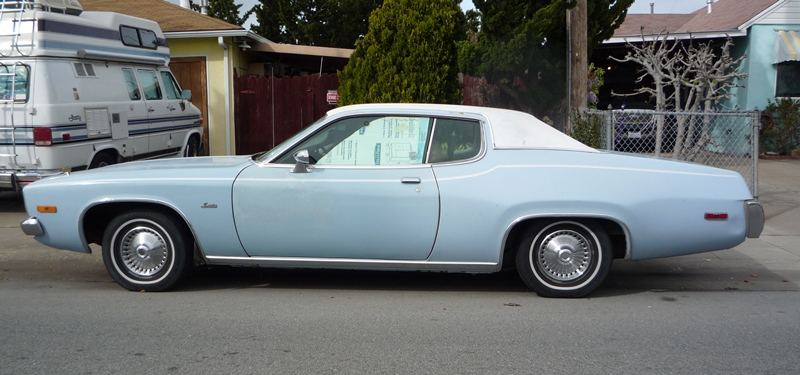

Halo tops

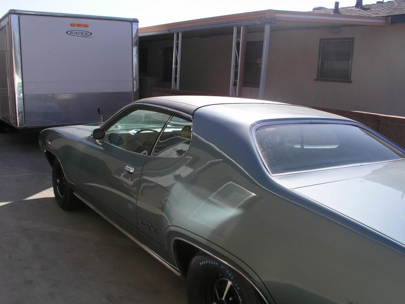

71 X canopy
