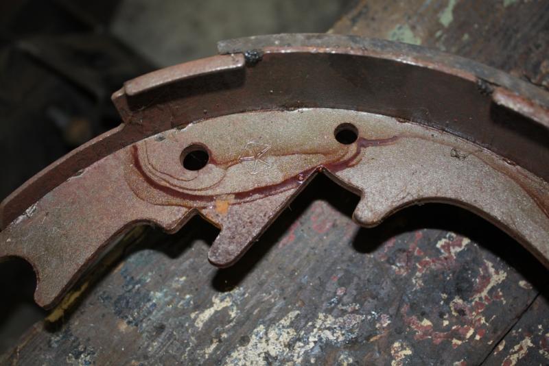

I have never seen a date code on brake shoes. Original finish, pentastar, and construction are the only way I know to identify period correct shoes.
The finish will be a sloppy quasmoline like the lower control arms. They will be stamped with a pentastar on the back somewhere. The pads will be glued to the shoe, not riveted. See attached picture.
Hope this helps.

Thank you very much!!! Picture does help. And good news is my car has less than 39000 original miles.
