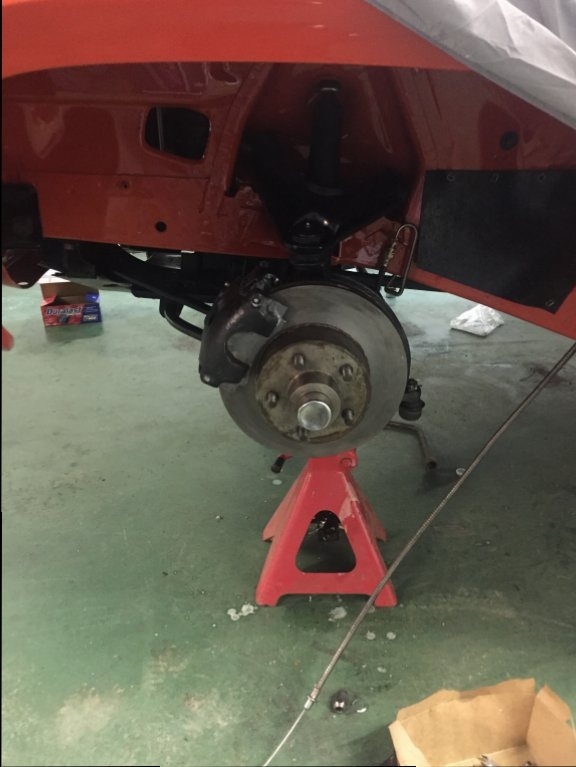

Are my calipers on backwards
Sweet, I'll just drive in reverse. Good thing I haven't installed the seat yet
Just turn the seat around, & you're all set to go ! Just put those clear lenses on your taillamps, so you can see at night.
Ah yea, almost forgot about the clear lenses
Success , the brake hoses fit much better once the calipers are installed in front of the rotors
check to make sure the calipers are not causing problems with your sway bar, especialy if the disc brakes were add ons and not from the factory. If they interfere with the sway bar, most guys switch splindles to the other side, putting the calipers to the rear and thats when you get a crazy setup with the brake hoses. But if your car came with disc brakes from the factory you will be ok.
