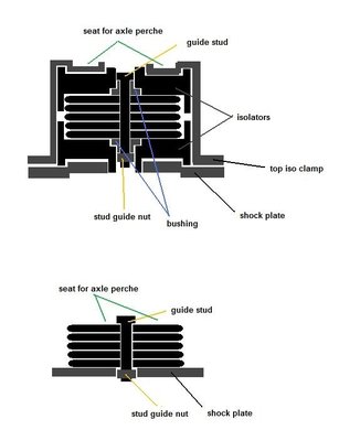

Lastly, the isolated mounts have a large hole, about 1.5", to accommodate a rubber isolator and the center bolt for the springs. If you remove the isolators, the springs will be able to slide around in that hole. YY1 suggested to me a while back that I could weld a washer into the hole with a center big enough to fit the spring bolt into, but I just opted to keep the rubber on mine.

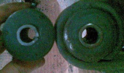

here you can see what I'm talking about. The busing installed on guide stud what will need to be removed from your existant old springs setup and be installed on the 71/72 springs.
Now MY EXPERIENCE was the 71/72 springs I found got 5/16" studs and my 74 got 3/8", so simply clamped the leafs and drilled the new diameter and installed new guides and the old bushings

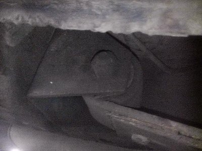

this is my front spring hanger setup... INITIALLY I installed the large diamter inner bushing because I didn't know this difference, BUT after install them NOTICED lot of play between bolt and bushing. Then I got new bushing ( the one on the left ) to replace the ones I replaced wrong on my car. Need to note that the pic is not really helpfull ( old Nokia 6275 cellphone ) but is a fact the one installed on spring is larger inner diameter and the one on the left is smalles inner diameter but BOTH are same outer diameter ( I ended instaling the one on the left
couple of years later working on my buddy's former 73 we found HIS 73 got the LARGE inner diameter... so MAYBE the 74s got smaller diameter inner hole to accomodate a thicker isolation into a STILL same round front eye spring and 71/73s got the bigger inner diameter? dunno, but it seems to be probably true. The truth is anyway, both isolations systems on his 73 and my 74 still got round front eye spring system.

The problem is the spring pads and other mounts on non-isolated systems use about a 1/2" hole, which is the size of the pin on spring sets. The isolated mounts use a hole that's about 2", which accommodates the isolator and the pin in the center. If you do away with the isolator, you're gonna need to fill in those holes so they have a 1/2" or so opening. As I mentioned, YY1's suggestion was to find a washer that will fill in the hole and has a center hole that will fit the spring pin.

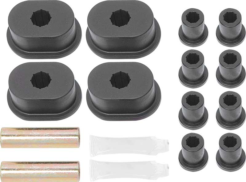

The pics you posted are of an early-73 and back, non-isolated, bushing. Here's what the bushings for the isolated set ups look like.
Bruzilla my friend I'm telling you my car got the full isolation assembly but still round front bushing, not the oval. The pics I posted are of MY 74. And the 73 a friend of mine had, it was also round bushing. we have discussed this in the past here... can't recall who asked about the same and talked about the same. It seems SOME got the oval, and some other not. Is not a local deal but also in USA
