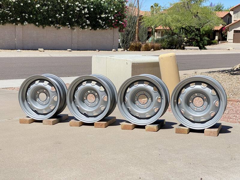

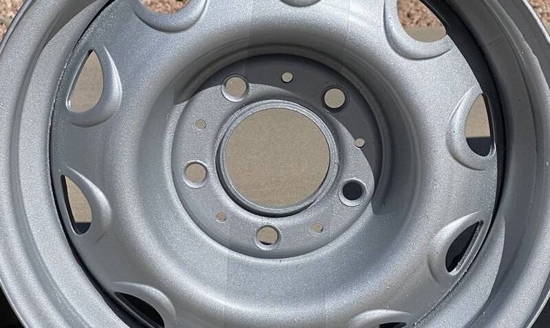

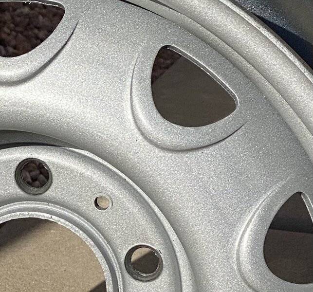

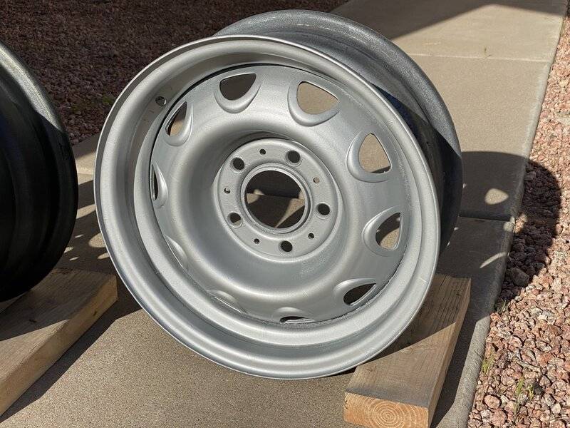

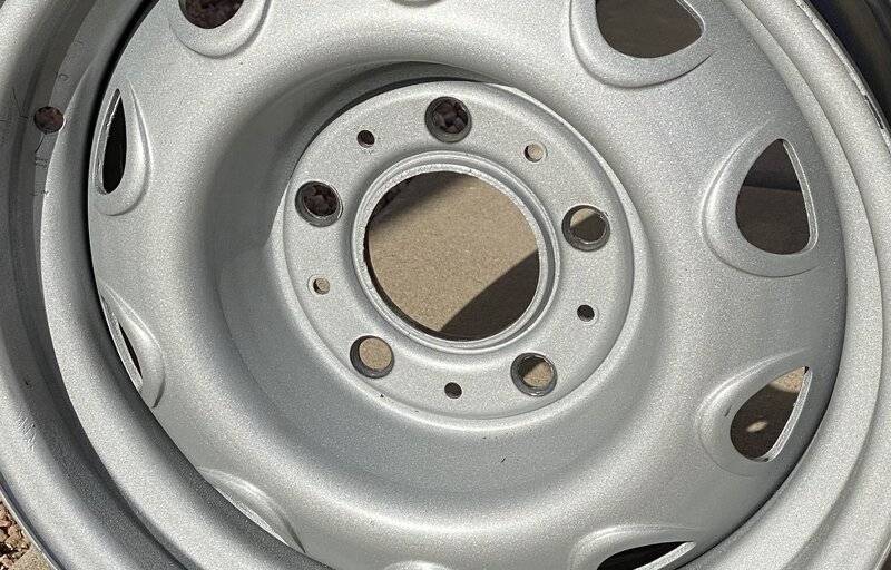

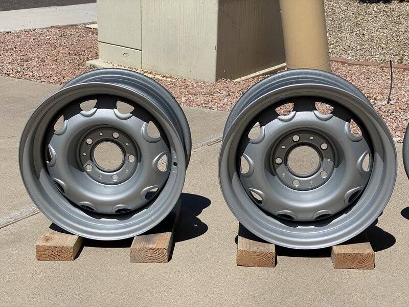

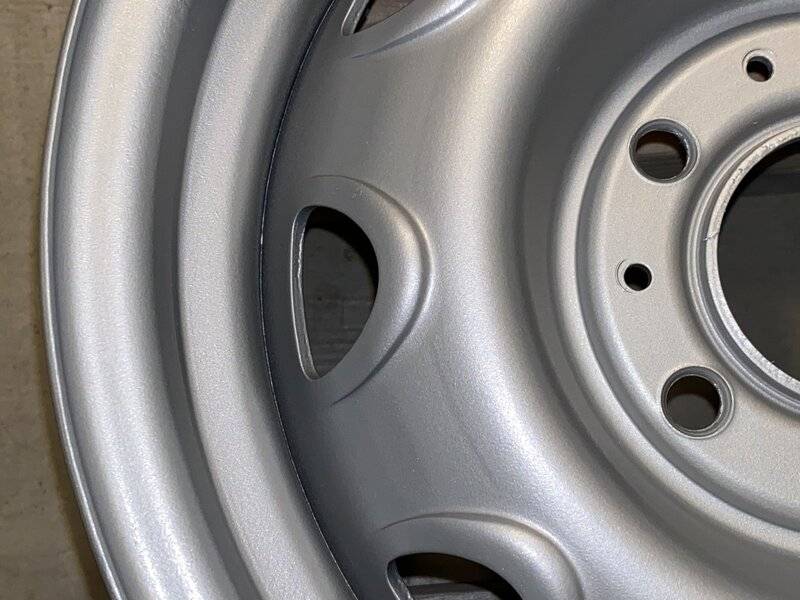

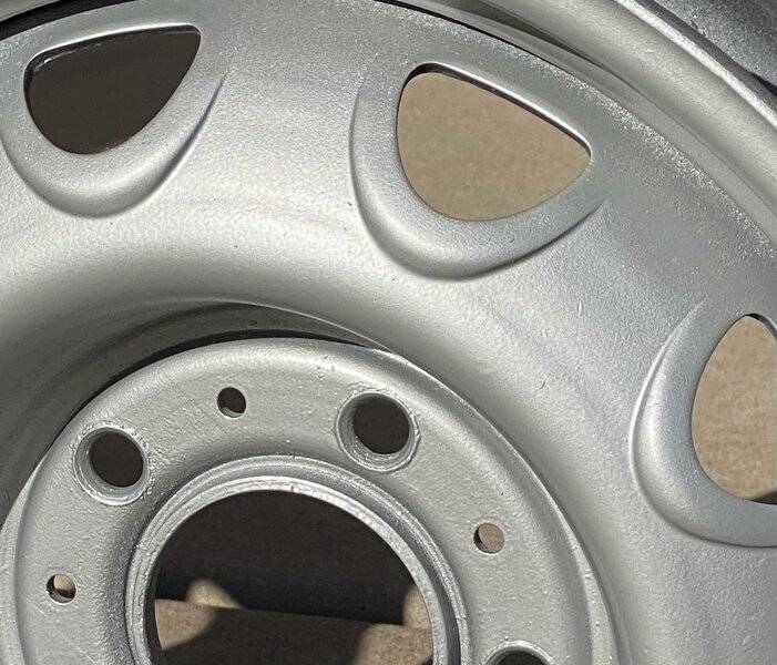

Let’s compare the way my wheels looked after spraying the PPG 8568 Non-Smudge Aluminum a.k.a. Silver Gray. After 2.5 weeks of looking at them, I decided that they were unacceptable. What is wrong this paint, you may ask?
Well, I’ll tell you.. The metallic particles are too large. The paint looks too gray. The paint looks too dull and lifeless, in any lighting other than direct sunlight. In direct, bright, sunlight it looks almost like metal flake paint. In certain lighting conditions the metallic particles take on the color of the blue sky making the wheels look powder blue instead of silver.

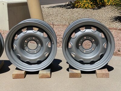

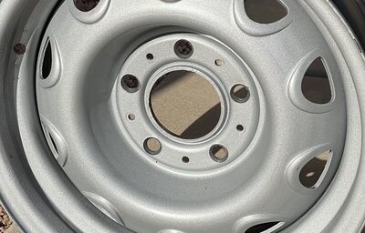

Here is 8568, in bright sunlight.
34829016-2482-424F-9DC0-8199B259885C.jpeg 9C6162D7-E3AF-4022-90C1-FC81CE8DE956.jpeg 497DA8A4-567C-489C-A2F4-7F8307036E00.jpeg

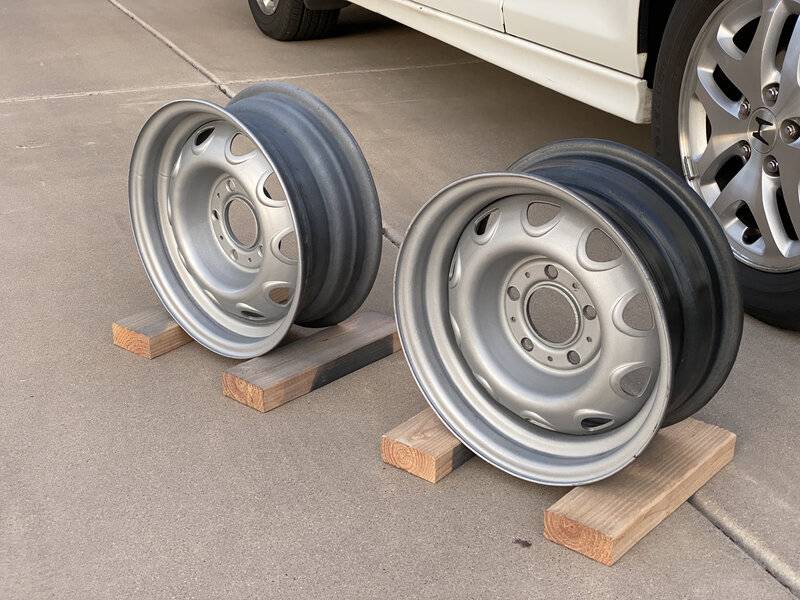

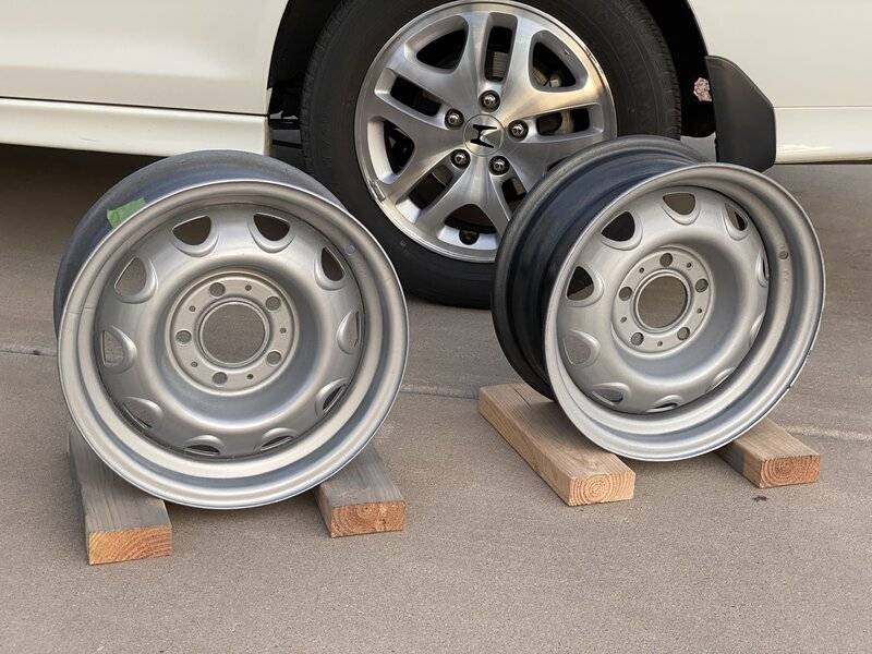

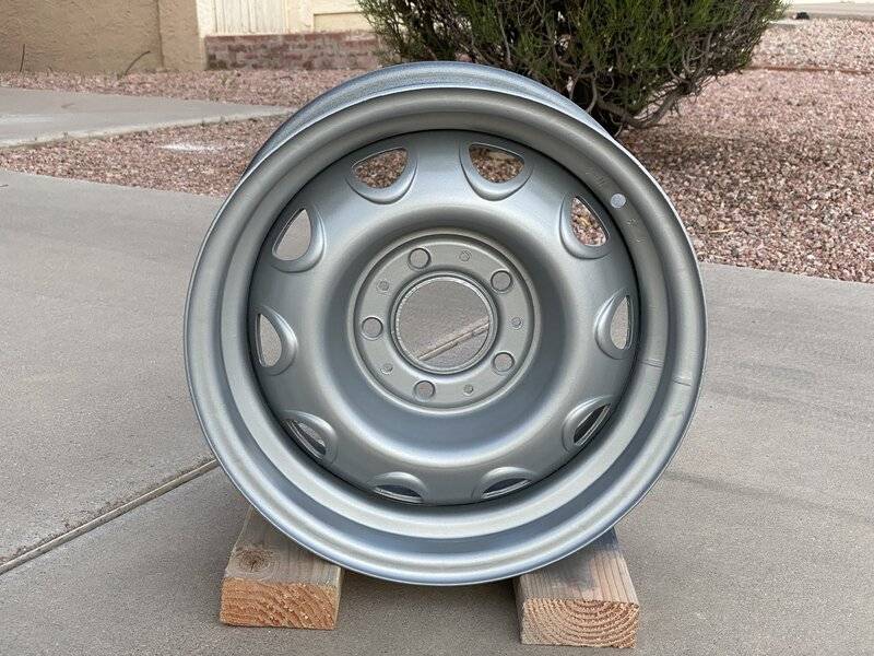

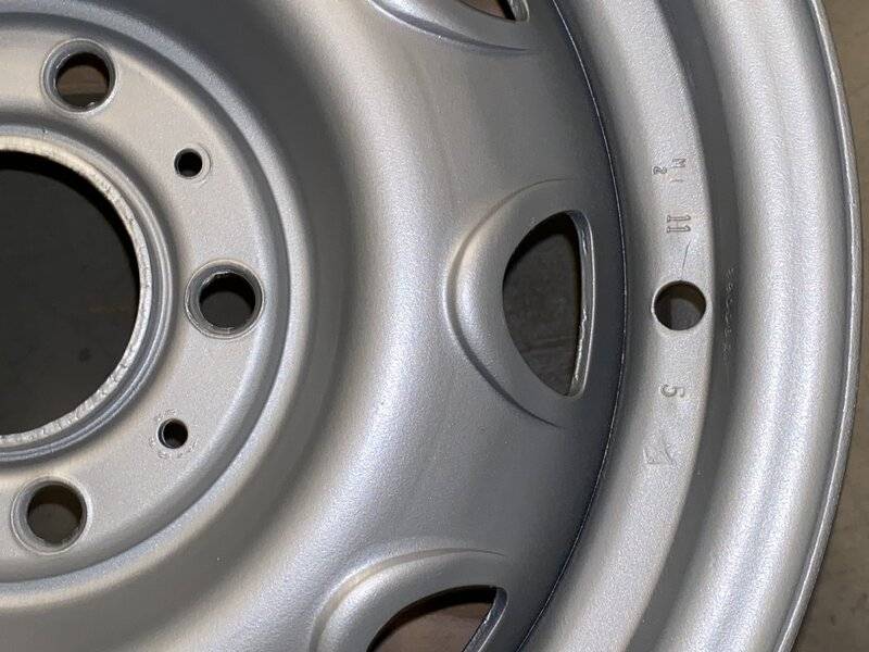

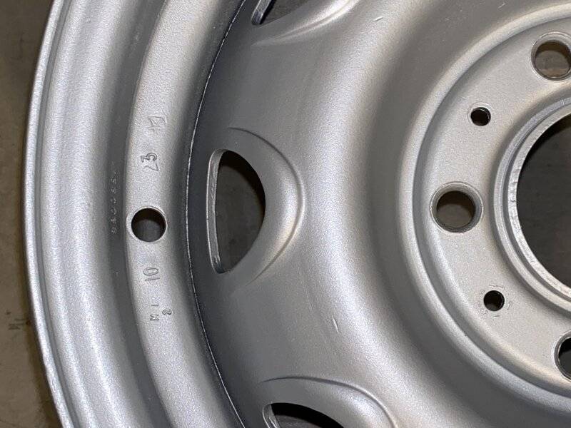

Here is the Roger Gibson Rallye Wheel formula, shot on a test wheel that was NOT even cleaned, let alone media blasted before painting. This wheel was primed and painted with the 8568, and two other alternative mixes, starting with spraying the primer directly over rust and dirt.. Even starting with a rusty and dirty wheel, it still looks better than the 8568 which was sprayed on a blasted and cleaned wheel.
7F1F5DAA-C716-442E-9522-63F0A46C4357.jpeg BCA1536E-AE33-4232-BCE0-09B46B0A36EC.jpeg 56A14705-F210-4C7F-B740-9DB78F822F5B.jpeg

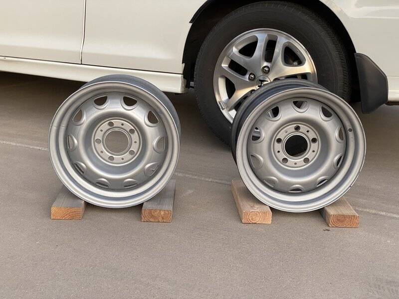

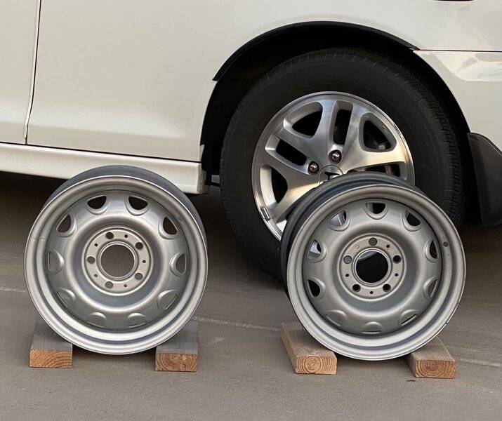

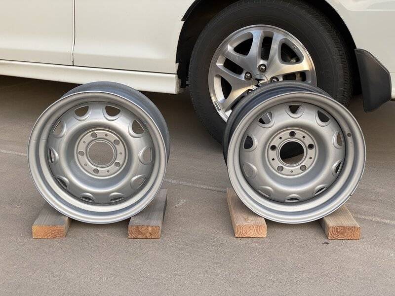

Next are comparisons of the unprepped rusty, dirty test wheel sprayed with the Roger Gibson formula on the left. And the media blasted and prepped wheel sprayed with 8568 on the right.
7D500017-6A5C-46CC-8075-A3350E2FFD2B.jpeg 66E2A59C-C187-4033-BDA5-933C3ED4304F.jpeg D0EFF626-28FF-44A6-91C7-608E9E66E061.jpeg 12A5A77F-817E-48F6-9C5C-2D81E986C9AA.jpeg

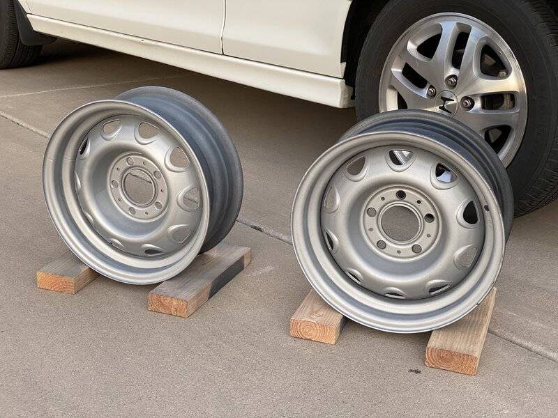

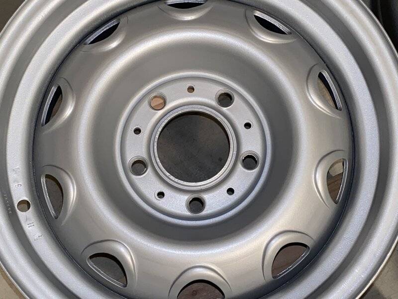

These two show how gray the 8568 wheel can look. Trust me, the 8568 looks even MORE gray in person than it does in photos. Like it’s more suitable for painting a U-Boat than a Rallye Wheel. Although it would fail at that, as well, because the huge metallic particles that are in it.
05433830-85CA-42D4-8419-BE23D9393E49.jpeg 56BDB092-7059-4C1E-B688-164671366D8D.jpeg

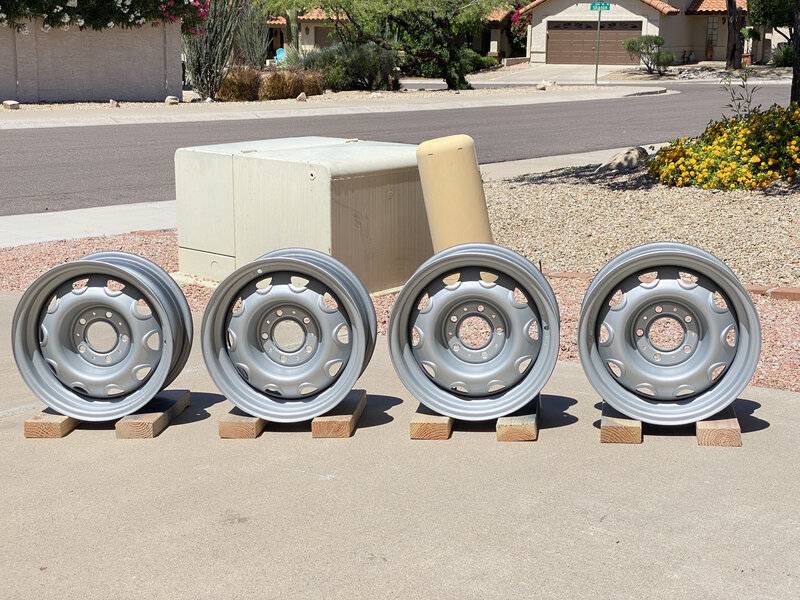

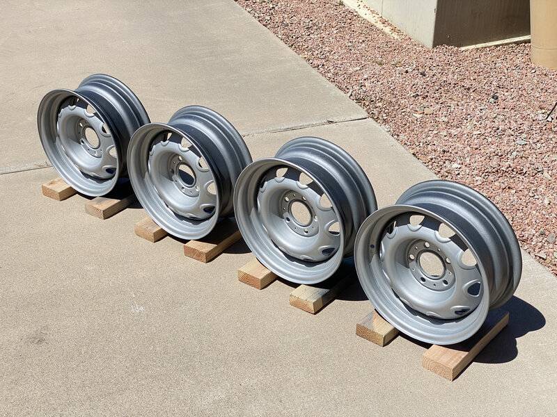

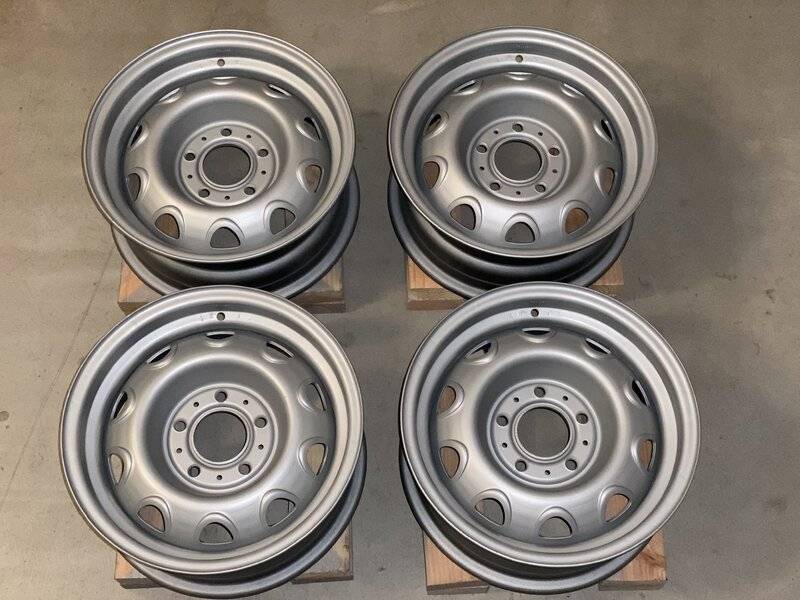

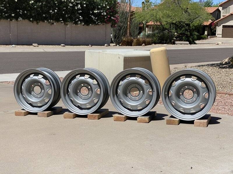

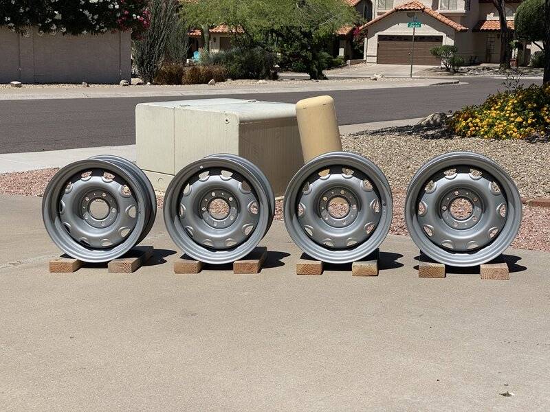

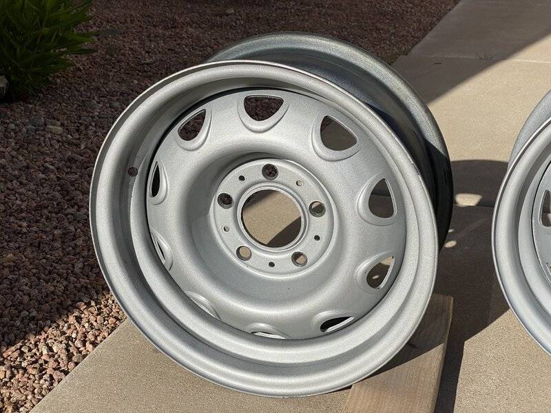

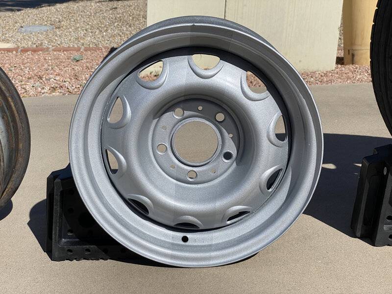

Group shots of all 4 wheels after applying 3 coats of the Roger Gibson formula. Regardless of the lighting conditions, now when I look at my wheels they always look silver to me, and not so damn gray.
48FDE3E5-1842-4513-BAC0-E3DE4DABD9FF.jpeg 46CB246D-2889-45E2-A6FC-F55341E0056E.jpeg DDEE99FD-E880-4359-A675-0B2550BD48EA.jpeg 8C87DC58-BA42-4F45-9DF9-89813B75F4E4.jpeg

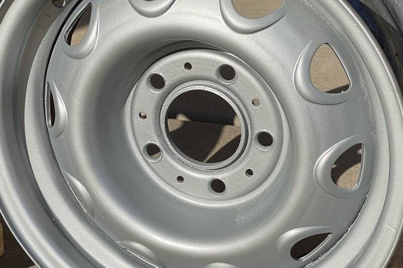

And lastly, close-ups inside the garage at night with a flash. After I get the tires mounted back on the wheels, I’ll be putting them on the car this weekend.
I’m happy with Roger’s formula. It was worth getting it and going through the trouble of re-spraying them to get rid of that awful looking 8568. If I ever end up getting a set of 15 x 7 Rallye, I’ll be sure to use Roger’s formula on them.
