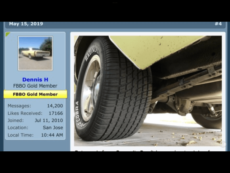

18 too modern. Personal taste I guess. 295/50 15 pictured.

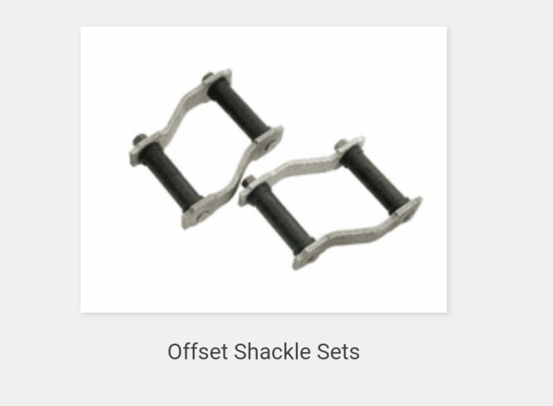

There is also a offset shackle you can buy that that moves the springs in to as close as it will fit wo modify the frame. They use it on the 71 and newer cars with the springs out farther. Not likely to work on a 69, there isn't enough room in the front mount.
