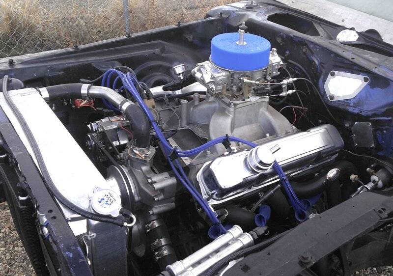

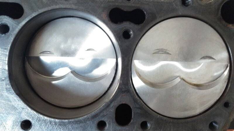

I recently purchased a stalled racecar project that hadn't been touched in about 8 years. Price was right and included lots of good parts. The 440 was supposed have been broken in but that was it for run time.
I changed all the fluids, squirted oil in the cylinders and turned it over by hand, cleaned the carb and flushed the fuel system. Hooked up a battery and cranked it over until oil pressure came up. So far so good, primed the carb and it fired right up and sounded really good with open headers. I checked and adjusted the timing, 60 lbs oil pressure, 165 degrees, still all good. It ran for about 5 minutes and than stalled out. It had lost compression so I dug into it and found the cam wasn't turning, here's what all I found inside:

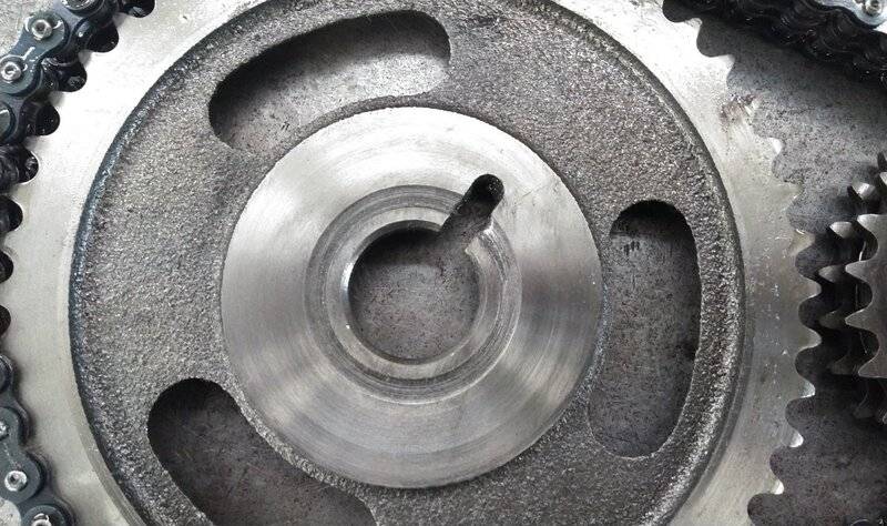

The cam bolt wasn't tight and the cam gear had spun.

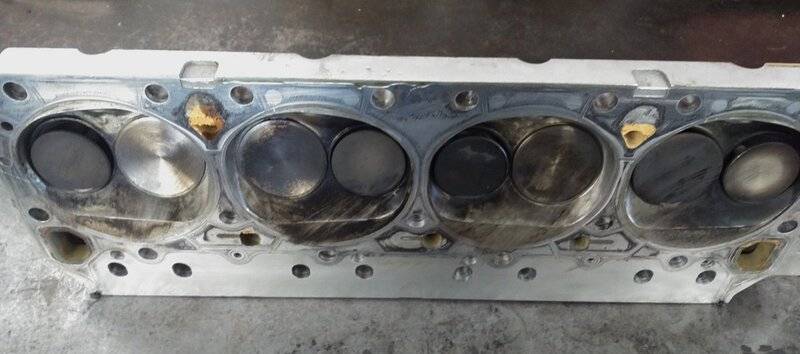

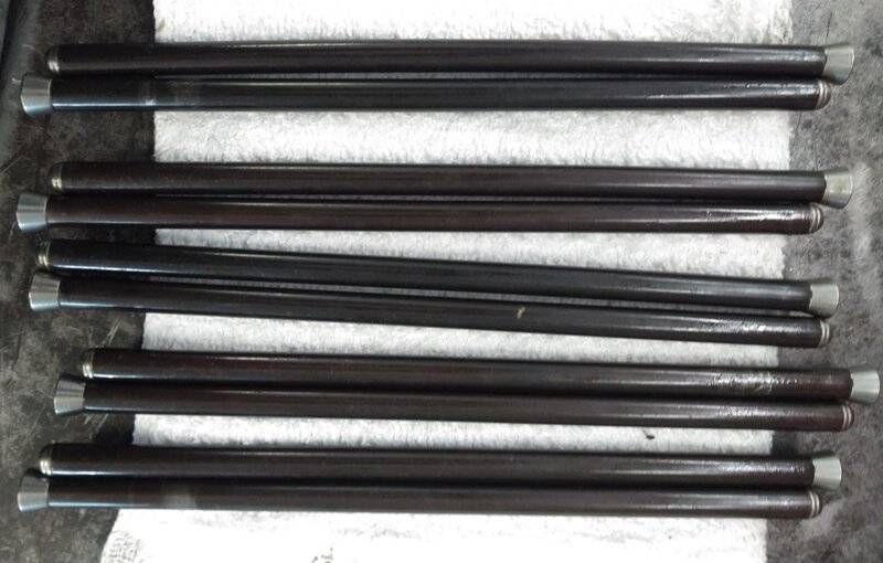

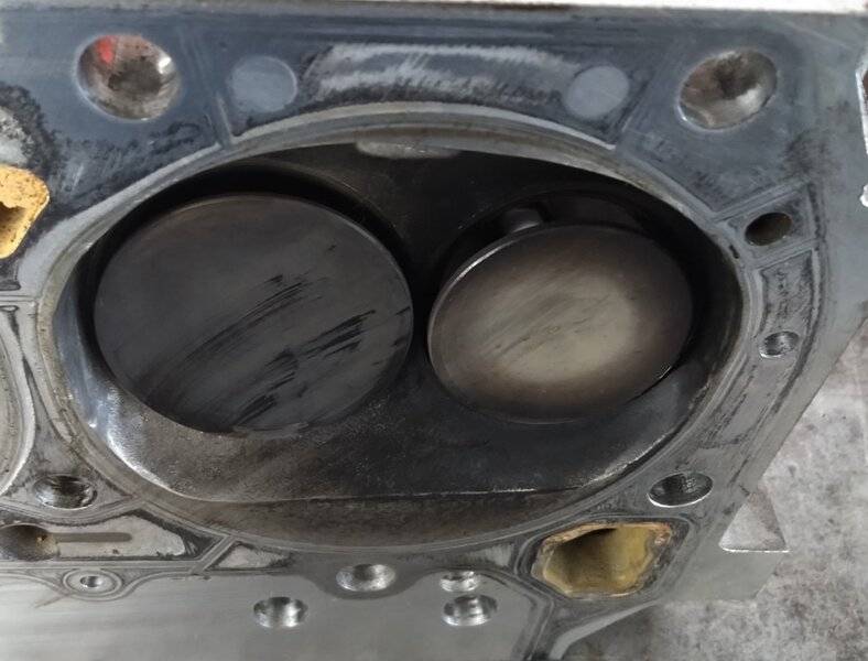

Which in turn caused the valves to hit the pistons, bending a bunch valves and pushrods:

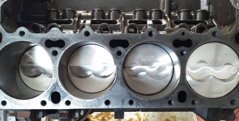

The cam is pretty mild and this probably wouldn't have happened if the pistons weren't installed upside down!
I also found a lot of loose bolts during disassembly. The whole engine is coming apart and I am going to measure and check everything before reassembling it.
Like my Dad always told me: Never assume................

It wouldn’t surprise me if there was v/p contact the whole time........ which could have caused the cam bolt to come loose.

I always loctite the cam bolts.
Thanks everyone. I hope that my bad decision will help others avoid the same situation. Yeah, the price was good enough that I will come out fine on the deal. I normally assemble my own engines and loctite, micrometers and a good torque wrench are part of the process. It definitely could have been worse.
View attachment 1271626 View attachment 1271627 View attachment 1271628
View attachment 1271630 View attachment 1271631

Unfortunately it's a single bolt cam, and I absolutely HATE the slot they put in the
top gear instead of a hole for the dowel pin! Blue or red Loctite and I believe 35Lb/Ft?
Pistons in upside down? Better check everything including the balance. Sorry to hear.
