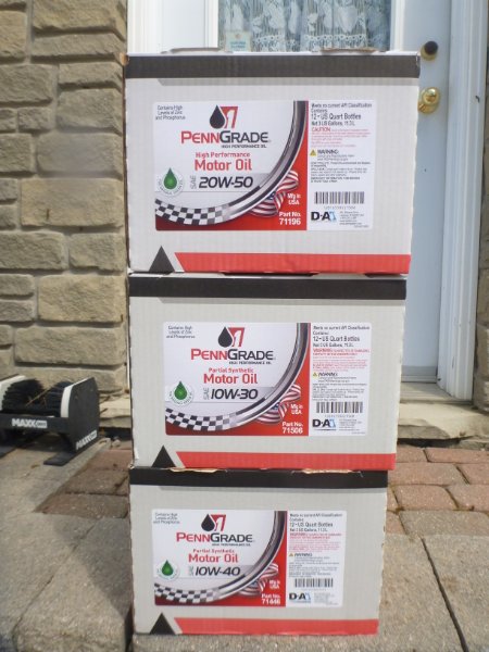

I will second PENN GRADE! I've had nothing but excellent results in both the full on race motor and the stroker in my Roadrunner street driven car.

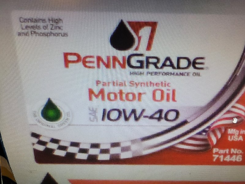

One more vote for Penn Grade (10W40 for me). And, like Don said, after the initial break-in, just run a good ZDDP oil.

Lot of great input thank you all, I hadn't even heard of using Penn Grade for hot rods looks like a good product
Where do you buy this Wayne? Is it Synthetic or crude?
I take it there is high zddp levels?
For the OP, I never really run the break-in oil long, maybe a 100 miles at most for me then I switch to an oil with high levels of zddp. A few here have already mentioned their favorites.
I order it online from a place in London, Ontario.
Penn SAE 30, I get it from Summit because all the parts houses around here have their private label brand or low viscosity multi-weights of brand name oil. Finding any type of 30W locally is almost impossible…
