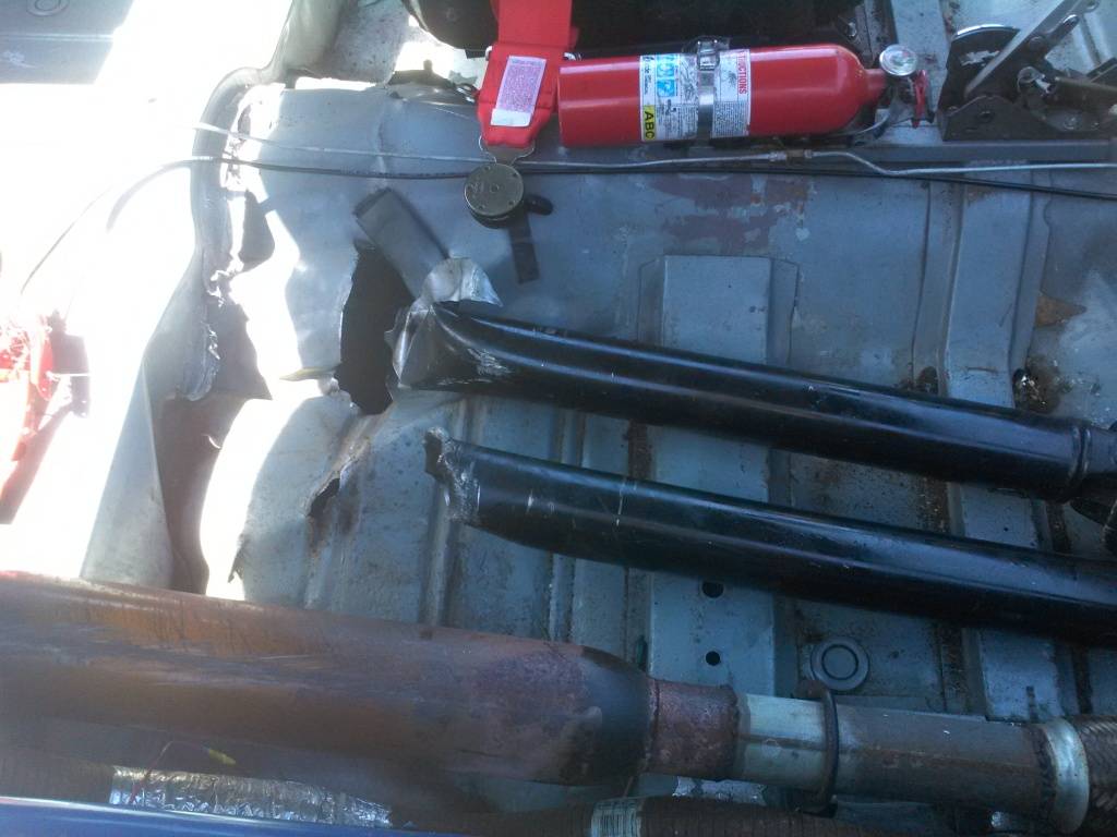

NHRA says 13.99 or quicker with slicks, 11.49 or quicker with street tires. I broke a stock driveshaft once in my '65 Coronet going through the traps, mid 12 second car. Tossed half the driveshaft out the back which flew directly over the windshield of my best friend in the other lane. Tailshaft housing disintegrated, output shaft bent about 2", trans case broken at the bell housing area off the motor. First thing I did when I bought my Satellite was order a 3" chrome moly thick wall shaft with 1350 U joints. A loop is mandatory in my opinion. BTW drag radial street tires hook as hard as many slicks.

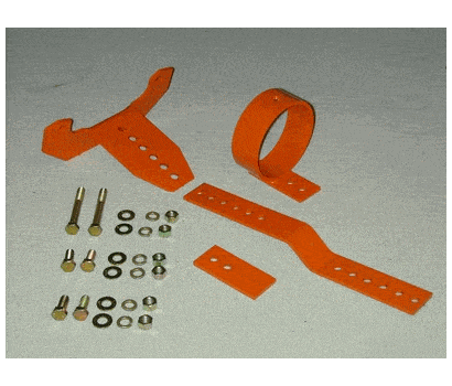

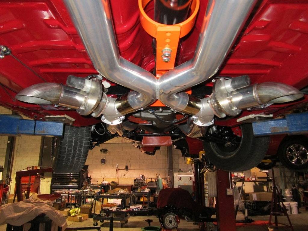

Built mine into the car frame - rocker to rocker - to also allow for mounting of my new Bucket Seats . . .

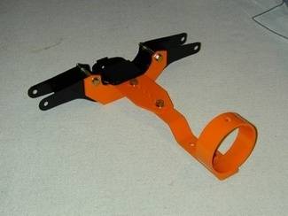

A COOL BOLT IN ONE FROM MANCINI RACING
Steel version, it's pricey @ $179.95
nice clean & easy installation
adjustable & bolts to the 2 center bolts on the transmission cross-member
MRE Drive Shaft Saftey Loop Steel bolt in-trans crossmember MRE-18055 $179.95.gif

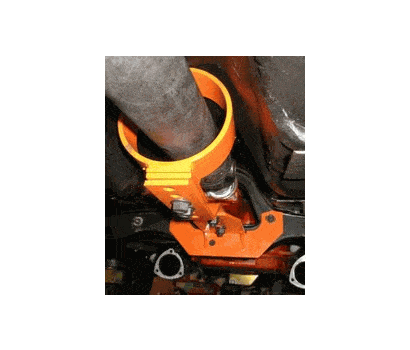

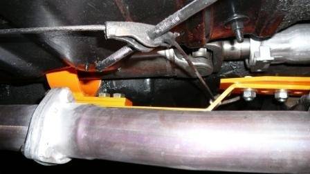

I have a similar one out of 7075 T6 Alum. one on my
"the B_I_T_C_H" she's a mostly street drive 68 RR
I paid far less, then that $179 too,
{they've doubled in price}
IIRC the name of the company I got it from,
1 x B-Mopar Driveshaft Loop, for $54.99 {Nov. 2010}
"Pro Aluminum Products", was what it was marketed under IIRC
my receipt was from
Prairie View Industries Inc., Fairbury NE...
it looks pretty much identical to the steel one from
Mancini Racing above
not sure if they still make them

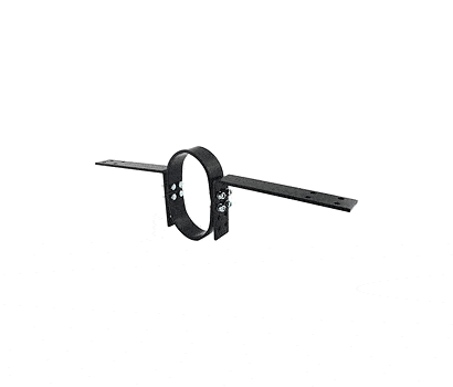

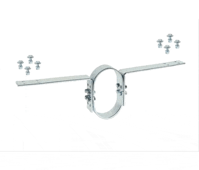

Competition Engineering sells like a $46-$47 universal bolt-in style too
but you need to drill the floors
MRE Driveshaft safety loop Competition Engineering bolt-in COE3028 $46.95.gif
Lakewood universal bolt-in for under $40
Allstar universal bolt-in for under $30
these are not anything like the quality of the
MRE {Mancini Racing} or the Pro Alum. Products
ones in my previous post

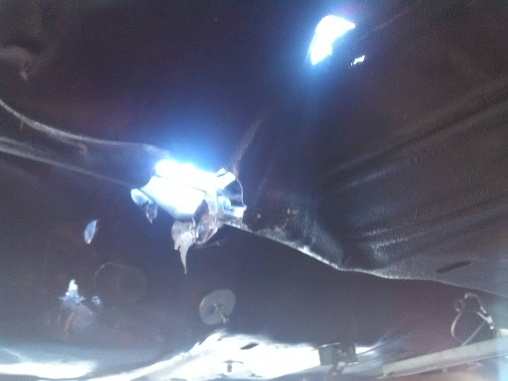

The exact same thing happened to me. Spit half the driveshaft out going through the traps (65 Fury) when the rear joint failed. Front half of the driveshaft beat the crap out of my exhaust and put a dent in the floor. Broke the trans at the bell housing and the starter broke off. Rear half was spit out and shot in front of (but missing) the guy in the other lane.
I still have the front half of the driveshaft to remind me to build in safety.
