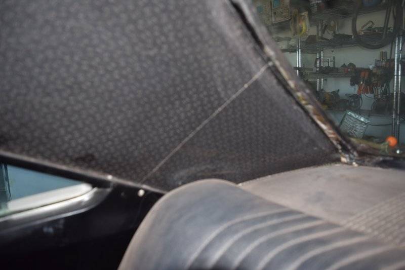

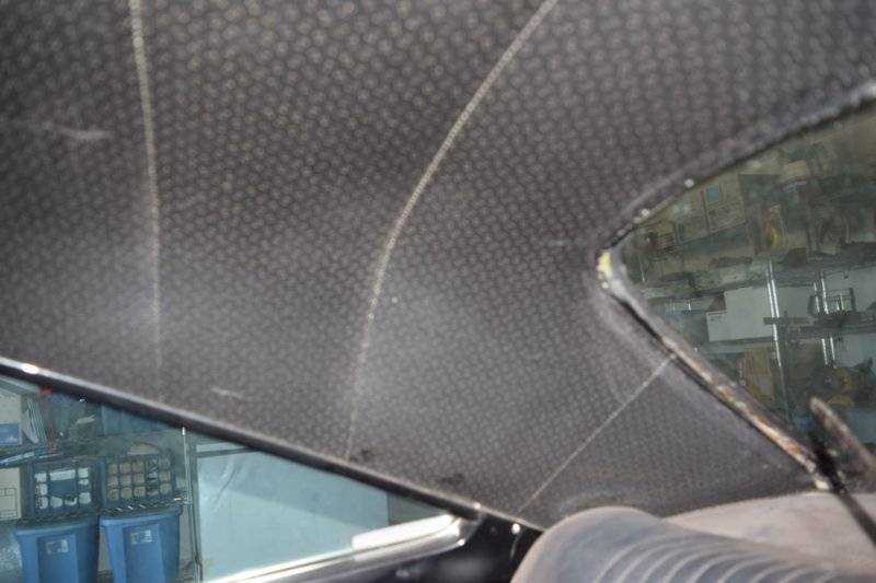

I looked closely at mine this morning. Mine has sail panel boards. After close examination I think it has been replaced at some point. The headliner itself has a more plastic look than an original piece although it is perforated as original. Also there is a slight color difference between the headliner and the sail panel boards but not as drastic as the picture will lead you to believe.

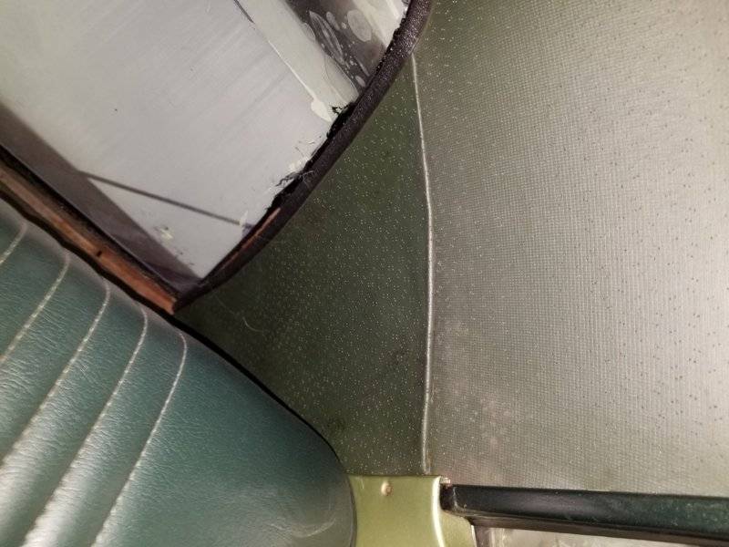

I checked out mine this morning too. To the best of my knowledge it's original and has never been replaced. The headliner goes all the way down, so no visible sail panel boards. There is, however, a tear in the liner on the one side and I noticed that there are uncovered sail panel boards underneath the headliner. My guess is that they are there to provide support in those lower areas by the rear glass.
Yes, you should have non covered sail panel boards under the headliner. This aids in the ease of installation and helps for the wrinkle free look. Not saying its easy by any stretch of my imagination. I have to hire it done, but always watch, so I know what goes on.
