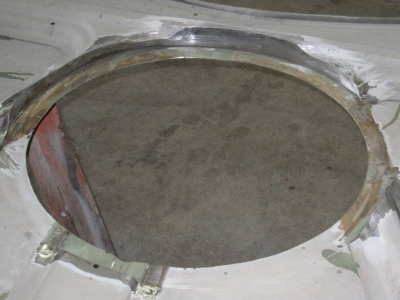

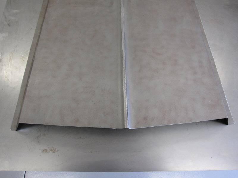

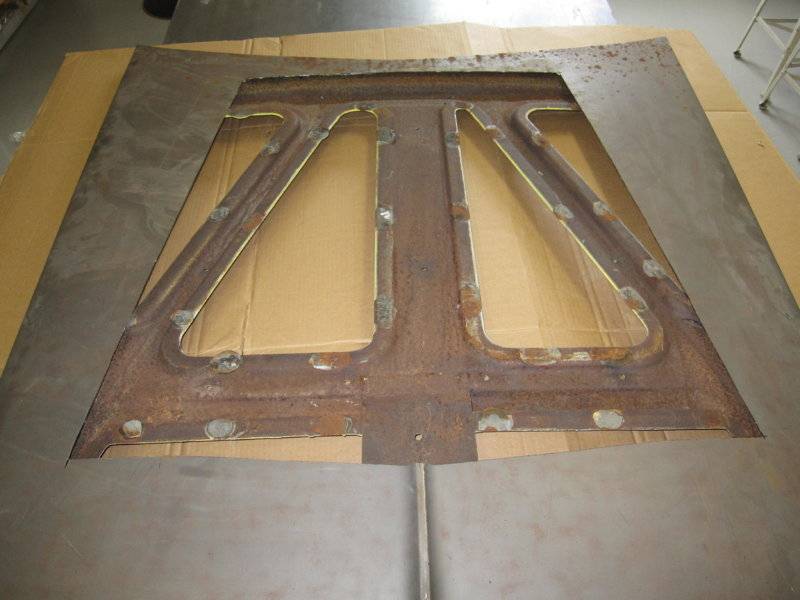

I'm building one for my 65 Belvedere. I fabbed the scoop from a bad hood and plan to glue/tack weld just the corners for attachment. On the good hood I cut a 4" larger than hole (in skin) in the reinforcement and boxed the cuts off (
do not weld to the hood skin). I will fab a air box from aluminum to seal the hood skin to the lower air cleaner base. By cutting the top angle of the box to match the hood to carb included angle I will be able to attach a flange to the top edge of the air box and add a thin strip of foam for the seal. I'm using a 16" x 4" air cleaner assembly.
Mike
I'm building one for my 65 Belvedere. I fabbed the scoop from a bad hood and plan to glue/tack weld just the corners for attachment. On the good hood I cut a 4" larger than hole (in skin) in the reinforcement and boxed the cuts off (View attachment 584324 do not weld to the hood skin). I will fab a air box from aluminum to seal the hood skin to the lower air cleaner base. By cutting the top angle of the box to match the hood to carb included angle I will be able to attach a flange to the top edge of the air box and add a thin strip of foam for the seal. I'm using a 16" x 4" air cleaner assembly.
MikeView attachment 584322 View attachment 584323

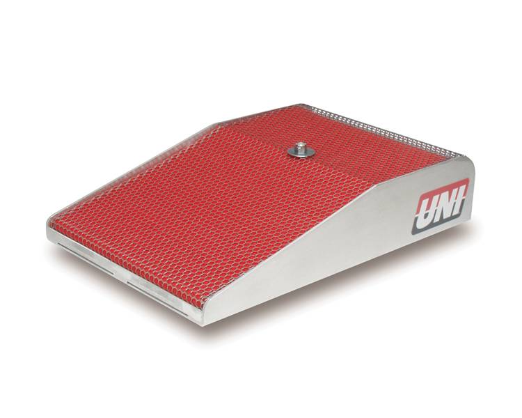

I have a Hemi scoop as well on my 67 and have been thinking about which one would optimize all of that air and do it with out building a pan/box .
I found this from Uni which looks like it may work for my application.
Mike, you said you cut the hole 4" larger. 4" larger than the normal cut or....
I cut the hole in the hood skin 2" larger than the air filter OD. as the filter extends above the hood and the cutback in the reinforcement 4" larger than the skin hole. This gives me room for the air box to seal to the bottom of the hood skin.
Mike
