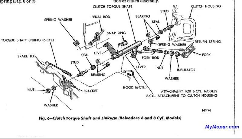

Think there's a hole in the inner fender to bolt ball stud. mymopar download a service manual.

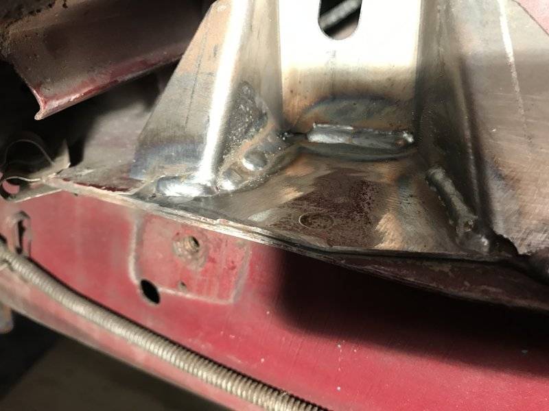

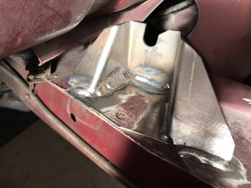

The clutch z bar ball frame bracket is located by referencing the locating “slot” on the frame rail.
5EA331DF-20F4-41D1-AB4E-53ED48D79AA2.jpeg 64803DCA-1E30-4960-8221-DE5039FC481E.jpeg
Notice the “V” slot on the top of the frame rail toward the front of the car. You place the bracket notch there for reference and burn it in.

The idea of the reference slot was so that a line worker could burn that bracket in quickly and have it be within tolerance.
The “ball” feature on the Z-bar allows it to work even if it’s a little “off” from perfect.
Obviously, you don’t want it too far out of wack.
Much easier to weld it in without the engine and trans in, so I made the decision to trust the factory reference slot and it worked like a champ.
My car has never been in an accident and retains all its original metal, so I had that going for me.
