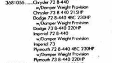

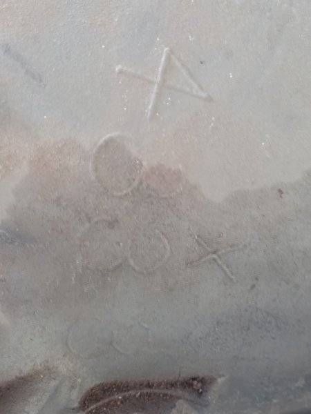

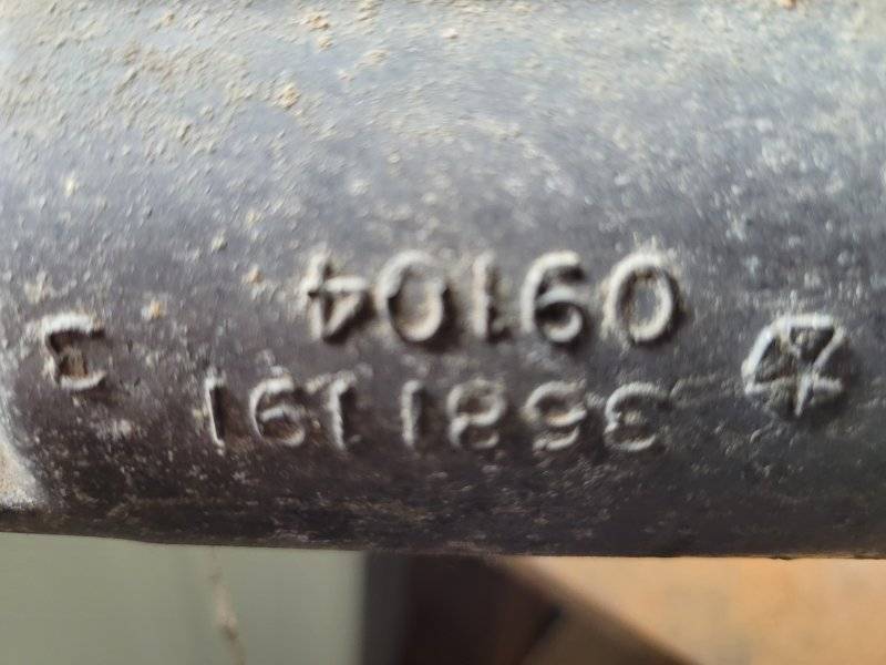

I just got the transmission out ,that I plan on using In my 70 rr with a 440. I took pictures of all the numbers on it ,appreciate the help.
Looks like 3681056 1972 c-body 440
