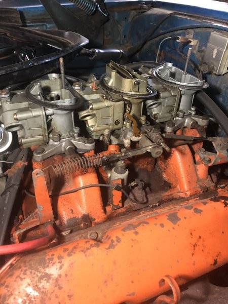

Six pack setup with Manual Transmission
i have the same one that Dave69 shows in his picture.
It's actually a '70 auto set that I ran on my Barracuda 4spd for years. Never used the solenoid....ever.

On the car, hooked up as original, running and driving.
thats the good stuff. thats what i needed. ill be identical except for the idle shutoff/run-on solenoid.
looks like i need the correct length 21.5" throttle cable for the 6 pack, and a cotter pin to hold in place and i should be GTG. i have the throttle return spring and bracket on order.

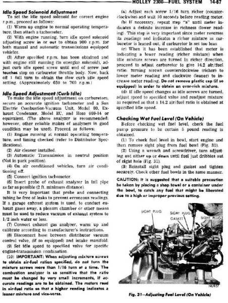

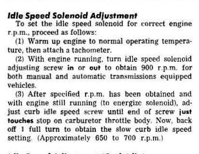

I guess you can call it what you want. Its design was to allow the desired idle speed of 900. The actual throttle blade screw was set to a lower speed which would be a couple hundred less. Normal running the solenoid is active allowing the 900 rpm's and when the key was off it would drop to the lower setting to prevent run on. . The procedure is here and from what I have read and know it had nothing to do with emissions.

It’s funny… I don’t have my 1970 FSM handy, just the 1968. But from that excerpt above, it almost reads as if they are telling you to disconnect the thing… without actually saying so. They allude to a “650 to 700RPM curb idle speed” that you would never experience with the thing energized. It’s always energized with the key in the run position.

You wont. Only way to get it on the throttle screw is without the solenoid powered. They tell you to set it with the solenoid activated. Turn the throttle plate screw in till it hits the lever and back it off 1 turn which is aprox. 650-700 rpms.
