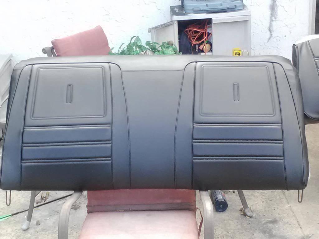

Ok, as requested here are some pics of the top...
and the bottom:

I don't know why people are so scared to do this themselves? It's really not that hard, no different than changing the sheets on a bed really. Cr8crshr was really reluctant to do his 300 when he had it, and was going to pay the man to do it. I told him I was going to do mine and he said he'd help and watch. Saw how easy it was and did it himself, with the help of me of course. It does go a lot easier with the help of a extra set of hands. Good job!
Thanks and I agree it's not very hard. I did have some wrinkles here and there, but I just left the seats out in the backyard all day and let the sun heat up the vinyl and the wrinkles were gone by 4:00. :)
